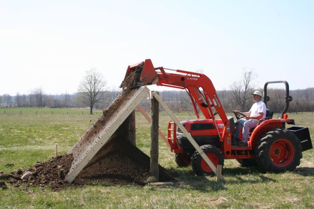

I built this one yesterday. I was going to plow a little pasture but my wife decided to move her garden. So until she decides where it is going I had extra time and lots of soil to screen. It is an 8' x 8' wood frame built with 2x6's and 1-1/2" heavy duty chain link fence secured to the frame. The frame is leaning on 2 secured fence posts. Works really well.

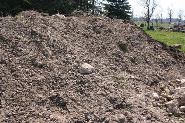

   / Screening soil? #6
Here is a picture of my soil before being screened.

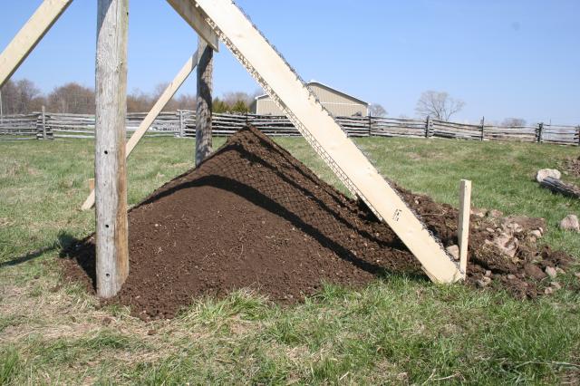

   / Screening soil? #7
Here is a picture of the soil after being screened.

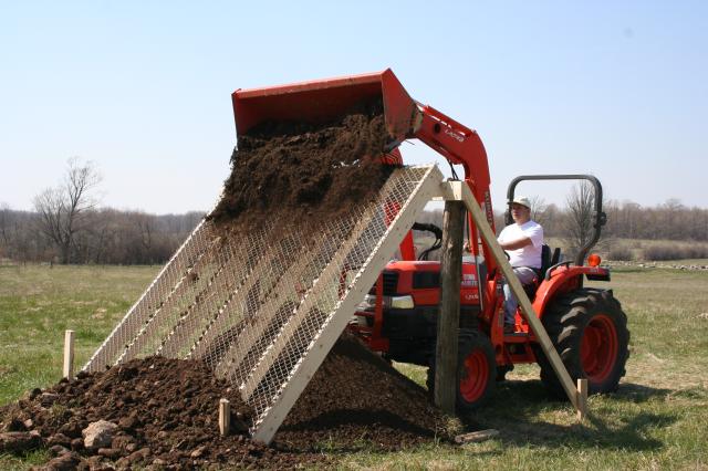

   / Screening soil? #8
Here is the screen in action. I am left with a few small stones about 1/2" in size and smaller. This is fine with me as I am sick and tired of picking up buckets of golfball size stones when ever I spread this soil around. I may just build a smaller version on wheels that can be moved to each new flower garden my wife decides to make and screen the soil on the spot.
