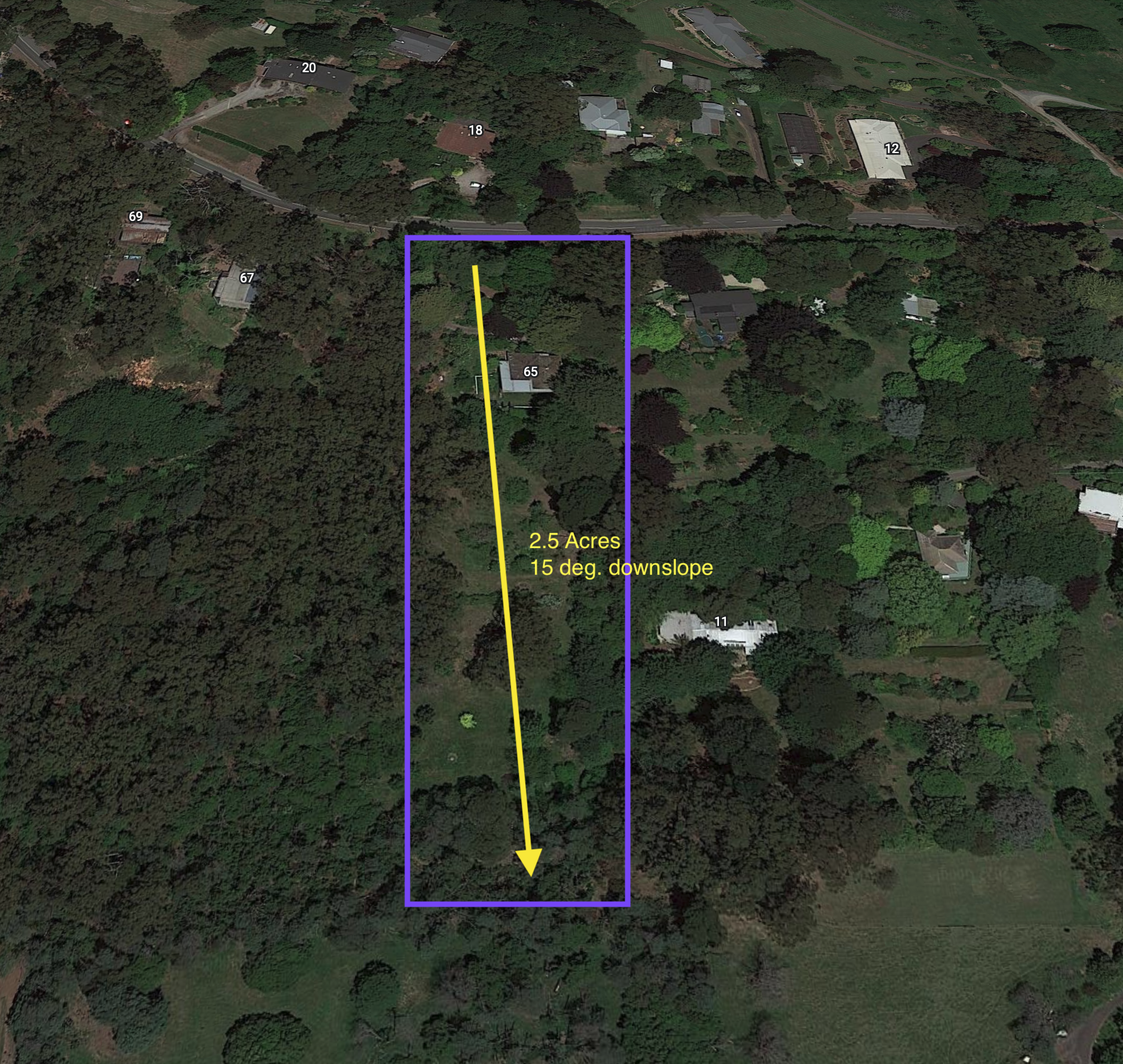

After five years man-handling our block with a 54" 25HP Petrol (Gas) 2WD ride-on mower, tow along 'trailer' and hand tools, I need to upgrade and could use your experience.
The problem I need to solve is I'm asking too much of my mower, belts slip or break, 2WD turf tyres are slippy, and I have so much material to move up and down the block, the 'trailer' and shovel aren't cutting it anymore.
I need to mow grass, move material (chips, compost, dirt, firewood, wood rounds) and dig some dirt for landscaping projects. No snow, no crop/ground work. Driveway is paved.
I'm thinking SCUT because of access but also cost. With the implements, Kubota/Kioti/MF SCUT are around $35k AUD ($25k USD) JD even more, and CUTs another $13k w same implements. CUT is hard to justify against renting machinery but if SCUT won't do it, then I'd rather not waste the money. Local dealers tell me SCUT is fine for a sloped property, machine will do the work safely.
I'm not asking which brand to buy, but if you're interested: I'm liking Kioti CS2610 (2 month wait) Kubota BX (5 month wait) I like the MF as well but I just couldn't get comfortable on it. JD is lurking in the background, in stock, but so expensive, 1025R is $10k more than the other three with same implements. All dealers are 30 mins away, offer onsite servicing and are reputable.
I would really appreciate your thoughts with consideration to the slope, if there are any? when buying a tractor.
I don't know what I don't know, but I know it's a lot! If there's something you'd recommend I think about, I'll take that too.
Here's a picture of our place in Australia, 2.5 acres with a pretty consistent 15 degrees (not %) slope.
Thank you.

If you are going to use a belly mower that you may want to take off for ground clearance when doing other things, consider the JD 1025R with it's drive over auto connect mower deck. If no mower deck then the tractor with the apparent lowest center of gravity. Fifteen degrees is enough to cause stability problems especially with a loader bucket anywhere above a few inches above ground level if you get sideways on it. Compare all the tractors you might be interested in on Tractordata.com looking at the dimensions page to compare weight, width and height. I am not a fan of JD in particular but in this class if a belly mower is in the picture that is the way I would lean. About the third time you work to hook up another manf. belly mower you may start wishing you'd gotten the JD. I'm 70 and the idea of struggling under a tractor to hook anything up is not very appealing at all.

Thanks mate, yes my intention is to use a belly mower. I reckon I’ll be swapping implements once or twice a month.

Tyre-wise, with a 15degree slope, I'd be looking at an R4.

Points to ponder:
1) ERGONOMICS, they matter. It will help short listing just by removing an ergonomicly uncomfortable tractor. Wagtail is very right about the surprising variation you will find.
2) Tyres, go Ag type as they deal with wet/slippery ground better.
3) Track, Get adjustable rims, tractors are default narrow , you want a wide squat stance for stability.
4) Loader , how high do you want to lift? LIFT CAPASITY : ASK where it is measured from. Measured 500 mm infront of bucket pins = good real world lift indicator. Measured from Bucket pins then is artificialy "good" and will likely be disapointing in real world situations.
ALSO: get 3rd service on purchase. Is cheaper than retro fitting, AND go for the large capacity hydraulic pump if possible, as it is good future proofing.
5)Most manufacturers have a budget and premium model in most sizes, so try both.
6) Tractor should have CAT 1, 3point linkage/3 point hitch, this will give you the widest range of impliment choice. Tractors below this are CAT 0 and have relitivly limited impliment choice. Cat 2 tractors are 60 hp up and to big for your situation.
7) SAFETY, Drive with the loader low to the ground ESPESIALLY when turning across a slope. A raised bucket raises the centre of gravity and makes it easy to roll the tractor SLOPED OR FLAT.
Good Luck and let us know which way you jump.

Since you are specifically asking about the 15 degree slope, I will add that loaded rear tires would be a good idea. Wider footprint had already been mentioned, which is also a real good idea.
While 4 in 1 buckets are a real convenience, keep in mind that the extra weight of this bucket will count against your lifting capacity.
