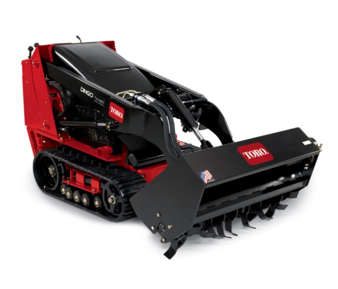

Hello, long-time lurker, first time poster. I have 2 acres, surround of 50-60' pine trees, with a lot of overgrown weed/brush/saplings growing in between. Land is 90% flat but for a slope down to the waterfront, which I'd like to clear too, but I have a Stihl brush cutter for that. So far, tasks identified for a machine include digging out landscaping, leveling/grading/reseeding several sections of lawn, removing existing fence posts; stump removal; retaining wall tearout and replacement, brush clearing in and around the pines...typical stuff, I gather. I have a blacktop driveway that I'd like to clear for the few times a year we get enough snow here.
I have a 60" zero turn mower and intend to keep it for mowing - can't stand the thought of taking more time than I do now to mow with a tractor. I want something that is maneuverable, and most of all, easy to store in my shed alongside the zero turn.
I really like the idea of a mini skid steer, like a tracked Dingo, or similar models from Vermeer, Ditchwitch, etc. They seem very capable, with tons of implements available to buy new or used, or to rent. Then I drove a buddy's JD 1025R. Loved that too, but I just can't dismiss the mini skid option because of the smaller footprint and the fact I don't need a mower deck capability.
From what I've learned lurking, seems like a Dingo is almost exclusively used by contractors, where SCUTs are used by both homeowners and contractors. I could see a clearer need for a tractor if I had more acreage, more need to clear it, or other, more ag-related uses. But I'm pretty much a homeowner with a big-*ss yard, so the SCUT isn't a clear winner for my needs, as I see them. That's where I need your help.
If I went with a Dingo or similar, what am I overlooking that would make me want a SCUT instead? Pricing appears to be reasonably close either way, so everything else being equal, what would you pick and why?

Just my impression, but the big advantage of a Dingo is hydraulic flow. Most SCUT's don't have a very powerfull hydraulic system, enough to just run an end loader but thats about it. Most of the time thats not a big deal since you can get a lot of stuff to put on a three point. The Dingo would have all sorts of options to mount things on the front that are hydraulic powered, such as a post hole digger, broom, etc. I would thing the attachements for a Dingo would cost more but I'm not sure about that. Just me, but it seems like the SCUT would be the way to go.

I vote for the Dingo. :thumbsup:

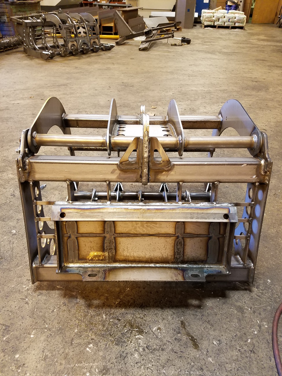

Toro | Dingo TX 427 Wide Track
EA is making a Wicked Grapple now that will fit it: http://www.tractorbynet.com/forums/attachments/369819-mini-skid-steer-wicked-grapple.html

You have to walk or stand on the back of the dingo . I had a ram rod , similar to the dingo , almost identical . Problem was when standing on it and you hit uneven ground , the family jewels and the controls were at the same level . I didnt keep it long

I see your point, net net is that attachments for either option are plentiful, and I can rent seldom-used items vs buy. Like the higher hydraulic flow. Just torn between having the seat on a SCUT vs smaller footprint of the mini skid.
The tracked Dingos don't seem to have that problem with the ride-on stand attachment, but I'm also curious about Vermeer, which seems to have a better operator platform. Or I could blow the budget on a Toro TX1000, but not sure $30K can make it by Accounting...
