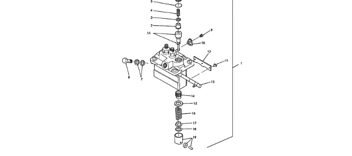

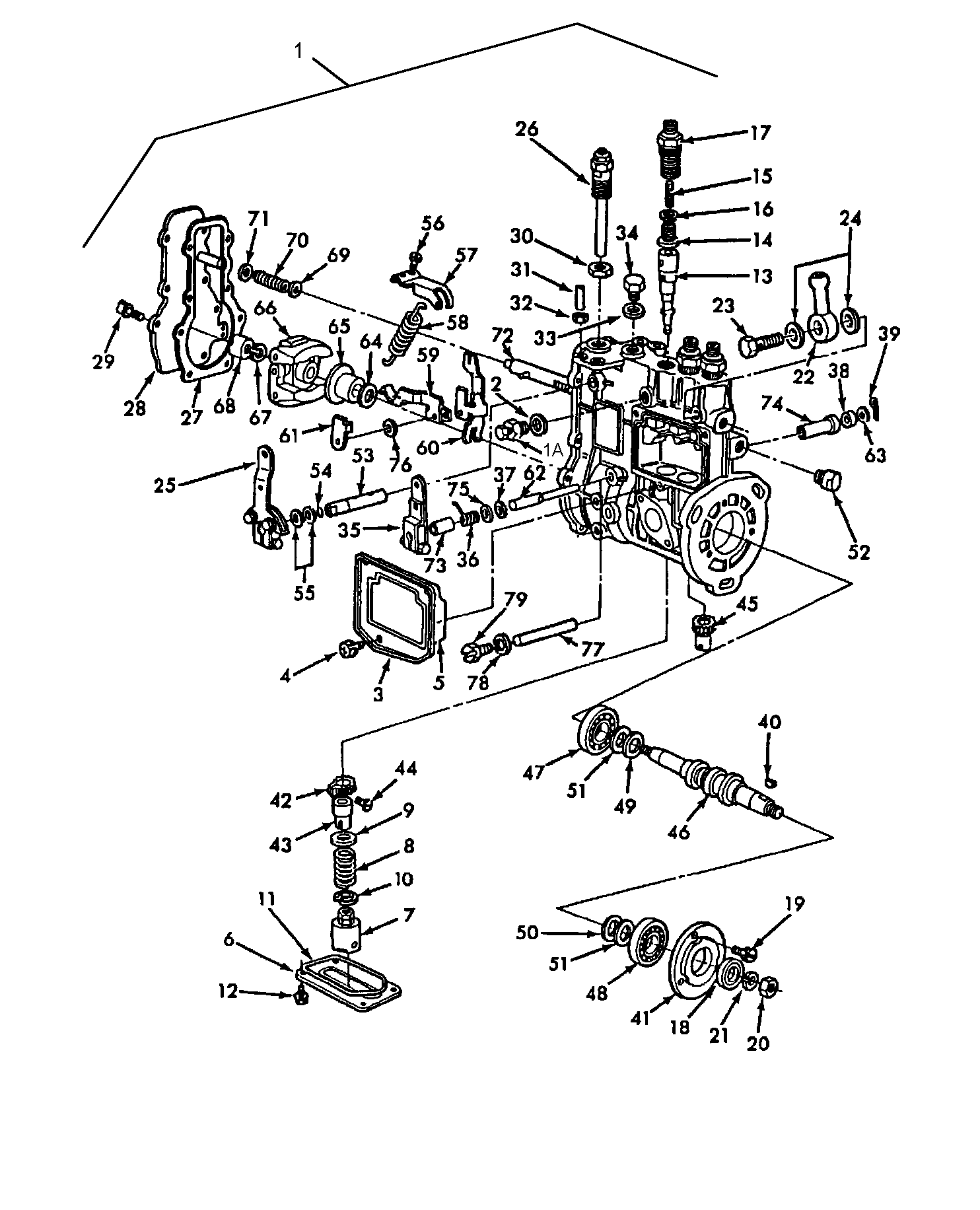

   / SD1500 fuel system bleed #4
I think the bleed is the screw to the left if it is similar to the Ford. You can tell which is the bleed screw on the filter as it is the shorter one. If you loosen the mount screw, of course, the filter will loosen up.
On the pump, it is the screw #8 in the in block style pump Injection pump in block.png and it is screw #1A in the inline pumpInjection pump inline.png.
You do not need to start or run the tractor to bleed up to the pump. This is done with at least a half tank of fuel and by opening the filter bleed first, letting the fuel bleed until there are no bubbles present. Then bleed the injection pump the same way. At this point, the tractor will start and stay running without having to bleed injectors, but if need be, crack all of the nuts on the injection lines about 1 to 1 1/2 turns, crank the engine with the fuel on until fuel steadily squirts out the injection nut fitting. Tighten the injectors and try starting. When you first crank it over to start, open the throttle at least half way. Once it starts and is running steady, slow it back down. If it doesn't start at this point, bleed again. If it doesn't start and there is no air present in the system something is wrong with the fuel system itself.
