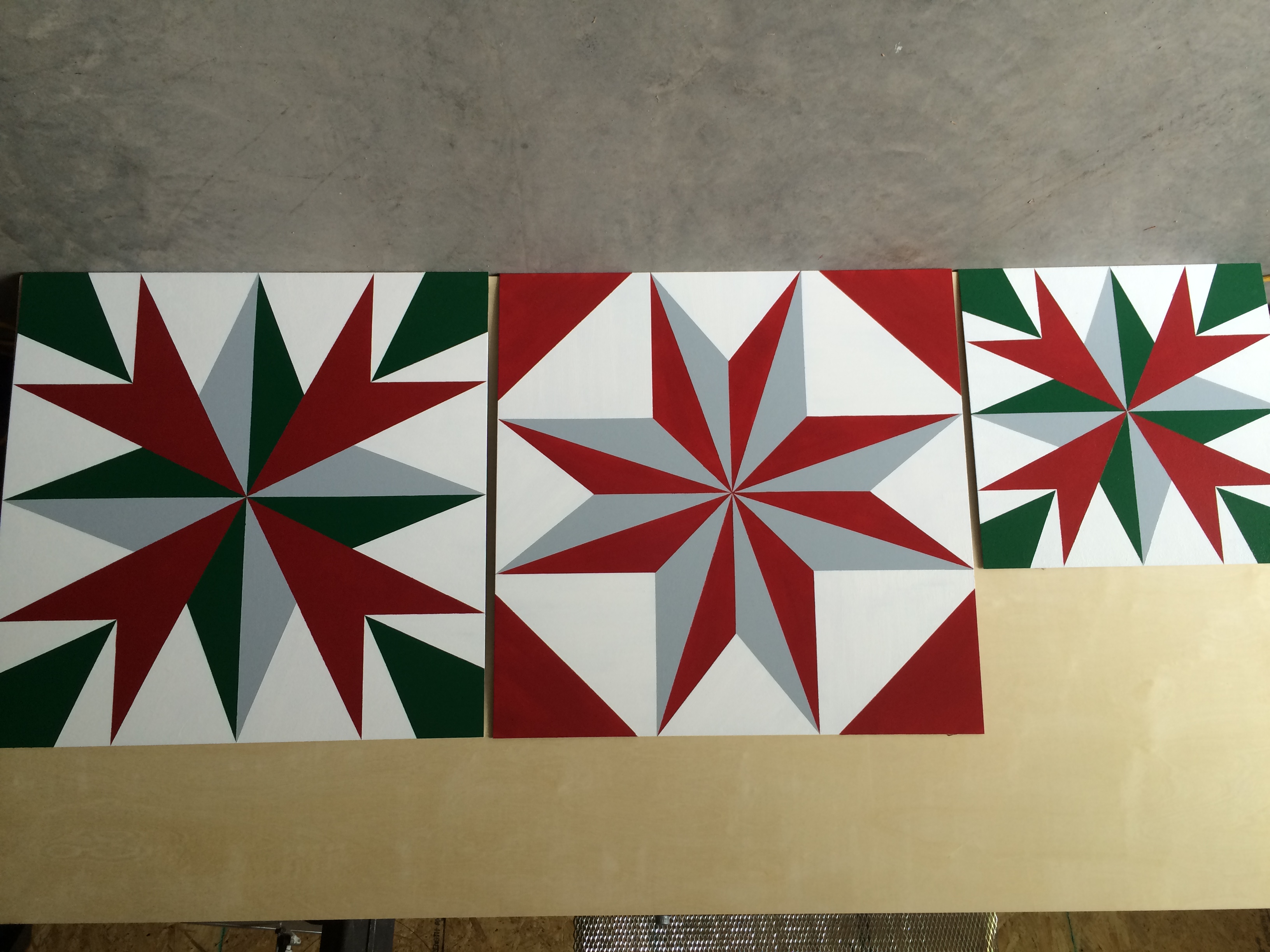

Unreal:D:D My wife wants me to do the same thing so I just finished this one. This pic is before the final touch up. I plan to star another one this weekend and have several people wanting to buy one. So it looks like I will be adding to the furniture I'm building and offer barn quilts.
I started with 3'x3' and did a 2'x2'. I will start with 4'x4' once I paint the next two 3' ones. I did 4 coats of primer and 3 coats of color's. I don't plan on sealing since everything I read said if you use a good quality paint there is no need to seal.
Be careful with the sealer it must allow the latex to expand and contract, if not the paint will crack from the heat and cold.

Finished another one this weekend.
