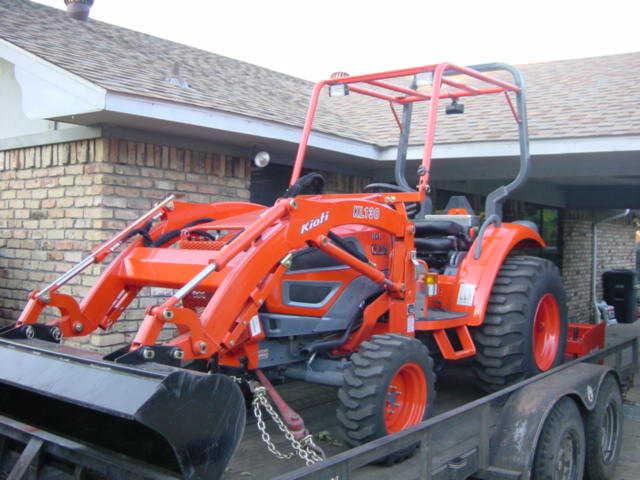

Put a full cage on your tractor, falling limbs and trees are a pretty real threat too.
