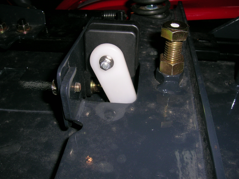

The first thing I did when my GC2410 was delivered was to "fix" the seat switch. I did not want to cut any of the factory wires so I was able to reorient the switch level arm on the shaft of the switch. I removed the switch, then the nut that holds the plastic lever arm onto the shaft, repositioned the arm clockwise 60 degrees, installed the nut and I was then able to tuck the arm into the seat frame and install the switch back into the stock mounts. Now the switch is always closed and I could return it back to the factory position in just a few minutes.
