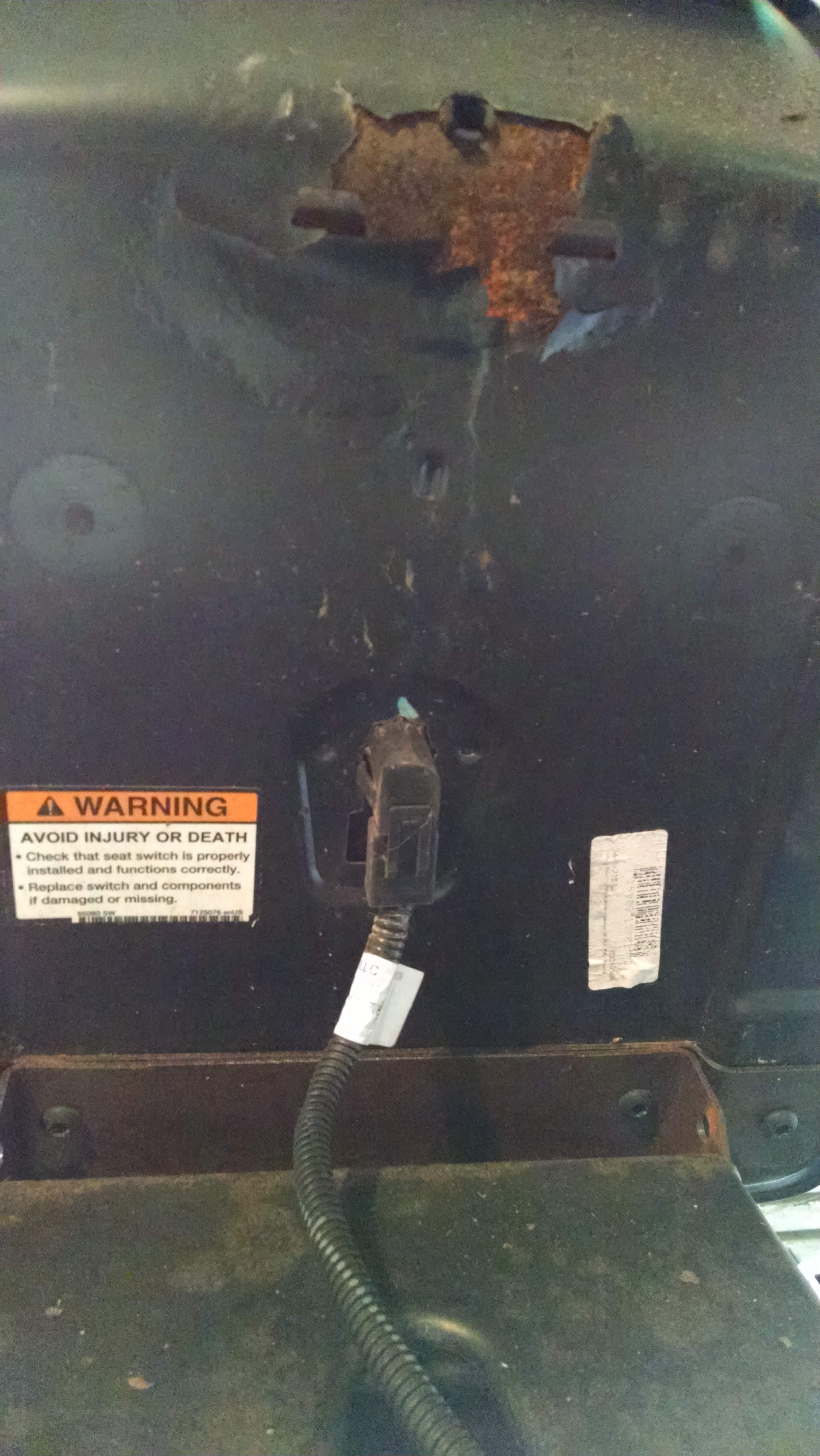

Several of us are needing replacement seats, but we have the deluxe ones (that have the weight knob and the switch is in the seat cushion).
I need a photo of the safety seat switch location on the standard seat. It is different than the deluxe one, and should/may allow us to use an aftermarket seat. The parts diagram is pretty vague on where it goes.
Please - if you know of anyone with a tractor with a standard seat, could you please stop and snap a photo.
Thanks
Also I have also checked on good seat covers, and found non for our seats in my search. Has anyone possibly found one.
My next step is to check with some upholstery shops, but I would love to get better lumbar support and folding arm rests if possible. Thanks

here is picture of the switch in the Standard suspension seat. Still mounts to bottom of the seat.
Only seats I can think of that have seat switches and arm rests are some of the Zero Turn mowers. Might try a dealer for commercial lawnmowers.
   / Seat Safety Switch - need photo of standard one
Dennis - Thanks much. I believe this gives options I did not have before. Now more searching.
