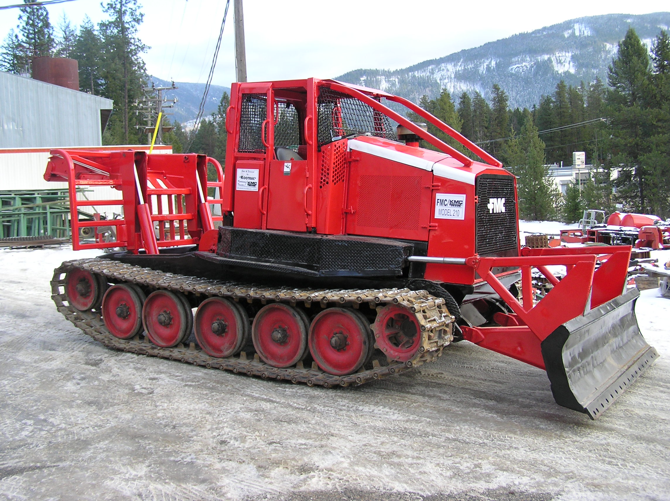

Plenty of power , ( 200 h.p. ) , light ground pressure , and with 4 speeds can crawl or haul the mail .
Fred H.
