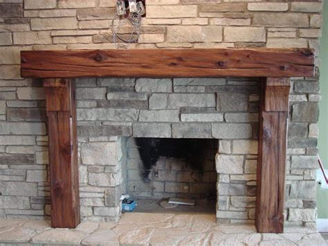

I am going to build the mantle out of it. It will be made of a rough cut beam from my sawmill. It will have 'legs' that go down to the hearth that the beam sits on. The design will be something like this (but brick, not stone and the mantle will not be as large):
I will need to secure this to the brick, of course, and would like to know the best way to do it. The mantle will be supporting its own weight vertically so the fasteners are primarily to keep it up against the brick. They will not need to support the whole thing.
I'm looking for advice on what type of fastener (Tapcon?) and where to drill. I'm assuming I drill in the mortar and not the brick itself.

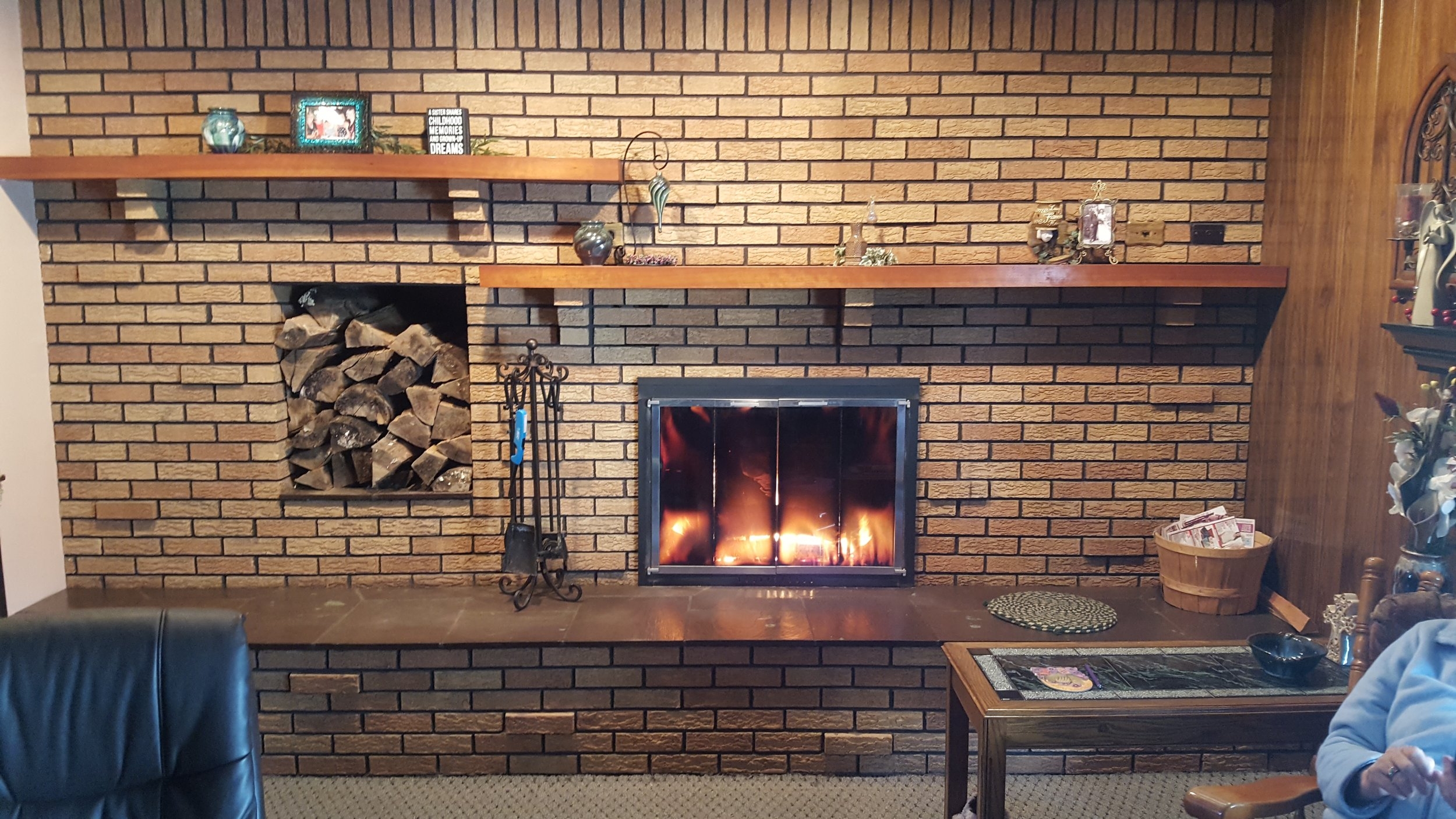

You may have your design completed and maybe not. The picture shows my fire place with a double mantel. Note the mantels just lay on the stepped out brick. They have remained straight and true for over 40 years. Wood box from the garage. Maybe you or some one else would be interested with this design. Later.

Seriously, I would insert 2 horizontal support blocks/stone/brick under your horizontal mantle. Then drill from the top of the mantle downward into the support blocks. This is what I did.

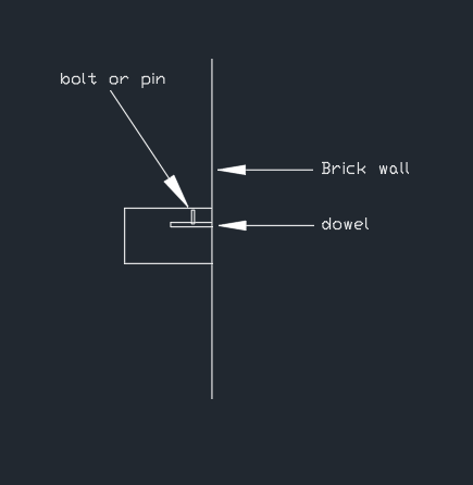

You could have two dowel protruding off the wall and have holes inside the beam for it to slide in and a counter sink pin or bolt to lock everything in place like the cross section below, this could be done on each vertical beams or on the top beam.
