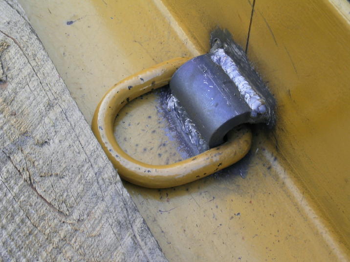

   / Securing tractor to trailer; California regs #9
If you value your equipment and safety on the highway,
weld four of these heavy duty D-rings on your trailer. /forums/images/graemlins/laugh.gif .
Don't forget to check the tightness of your chains, periodically,
they will loosen. /forums/images/graemlins/shocked.gif ...RayBee

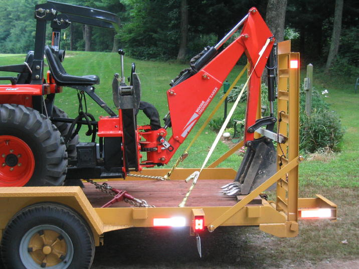

   / Securing tractor to trailer; California regs #10
I think ... using a good grade of transport chain and HD ratchet binders
will pay in dividends, down the road.
(This isn't the place to save a few dollars).
As you can see I also believe in
tying the boom of my BH. ..... Happy Trailering! /forums/images/graemlins/laugh.gif /forums/images/graemlins/laugh.gif ....RayBee
