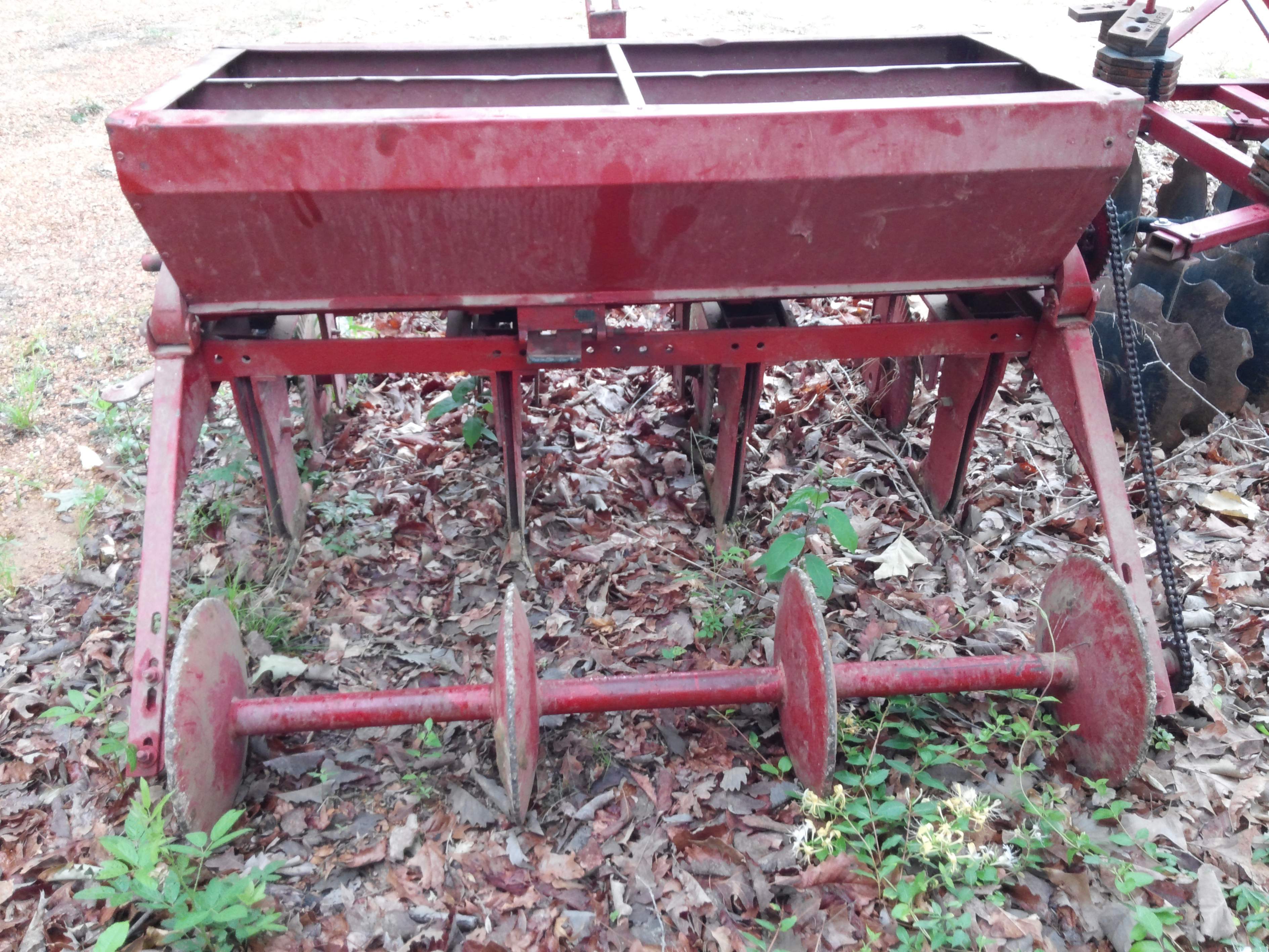

Be on the lookout for a Taylor Pasture Dream or Pasture Dream Seeder. These old units will plant anything no-till into existing pastures or food plots.

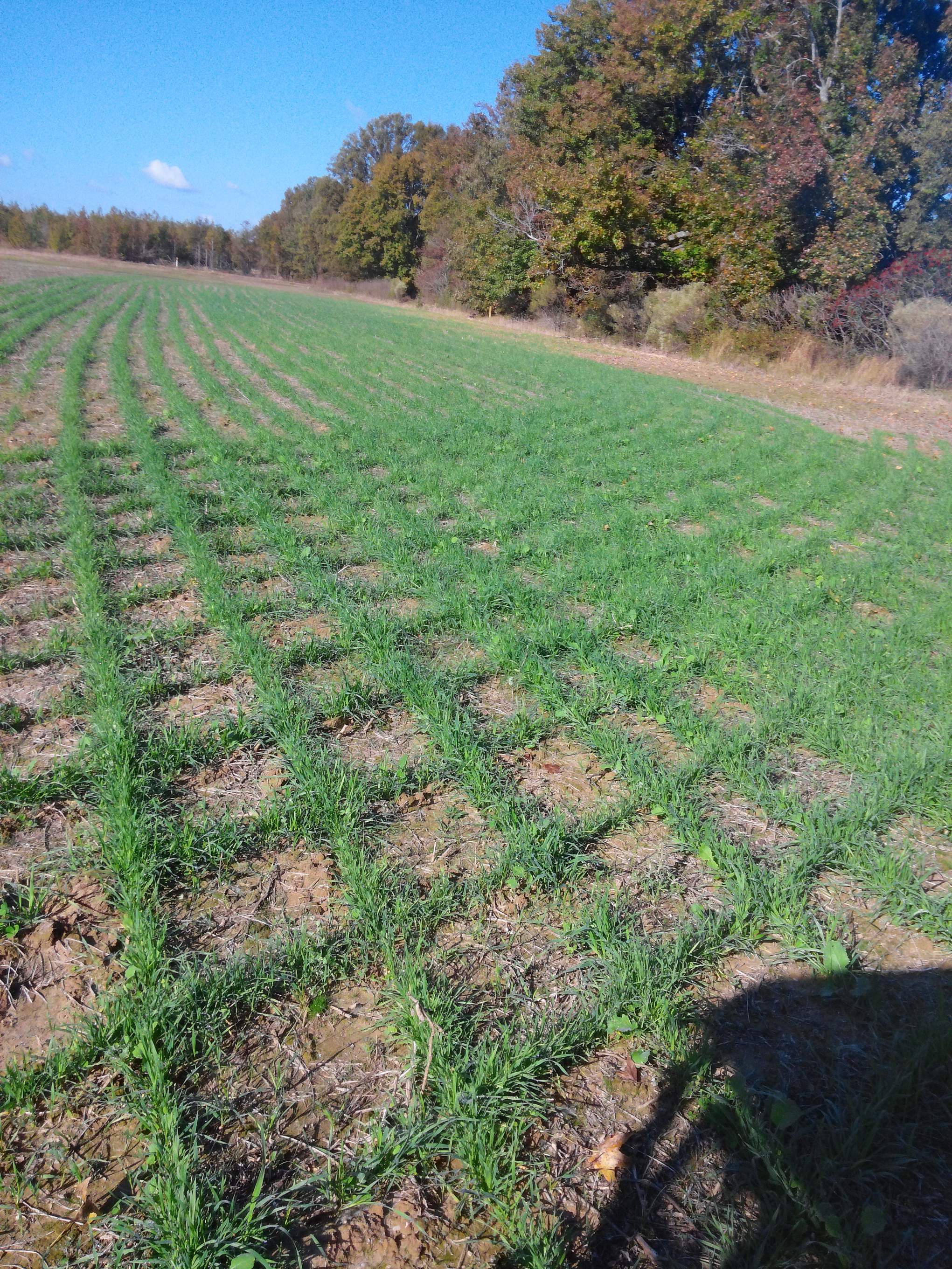

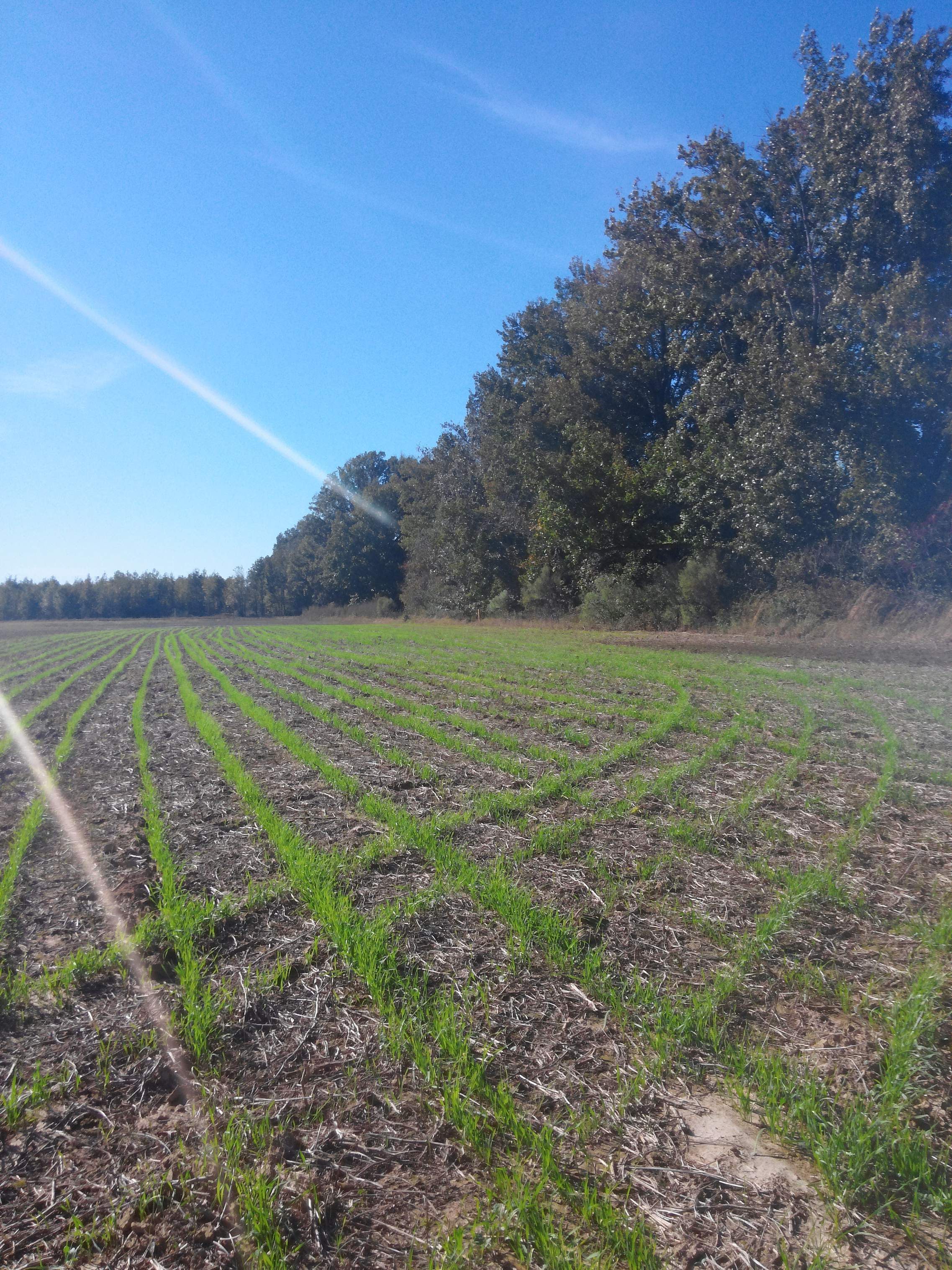

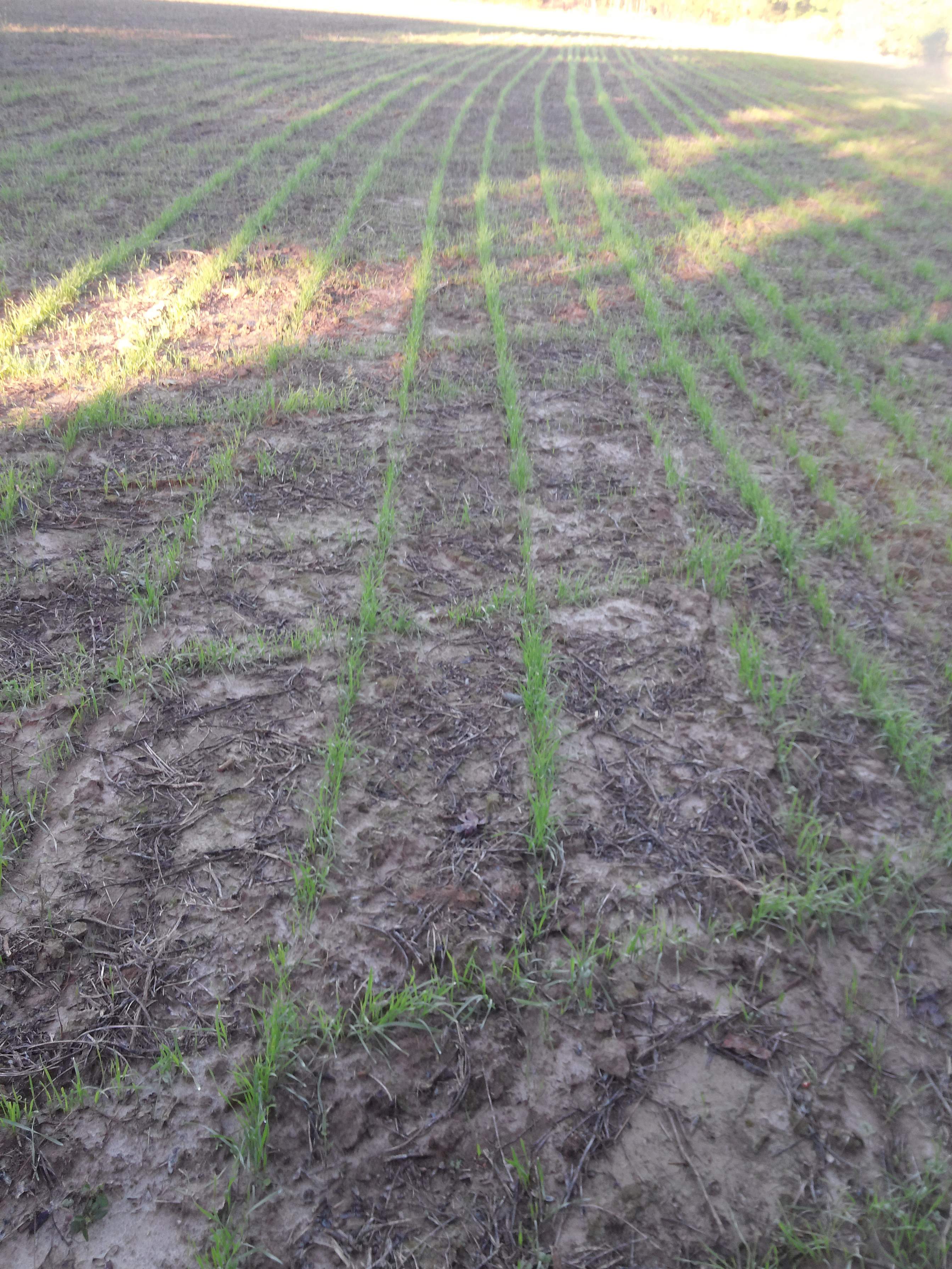

You can double pass plant on a diagonal ( 20" row spacing)

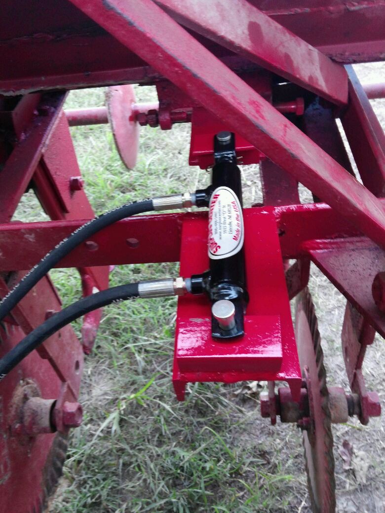

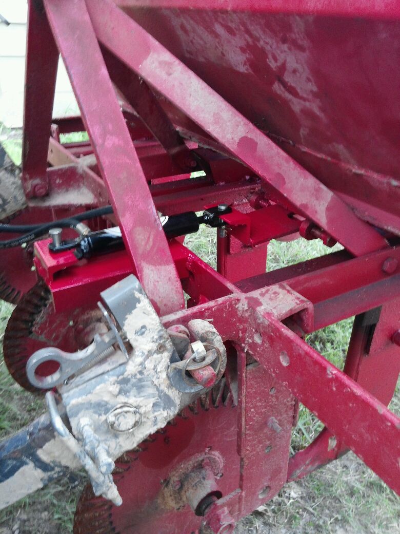

They can be modified with a hydraulic cylinder to operate the seed gates

First 2 pic didn't post of the planter I have. If you can find one they usually are less than $1K (I paid $350 for mine w/o lid and seed gate mechanism worn out)
Not mine but shows the mechanical seed gate that is usually worn out
