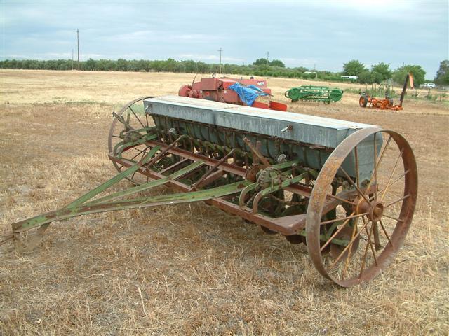

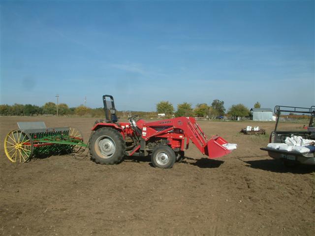

I bought two old Minneapolis Moline P3-6 grain drills (10 feet wide, 20 drops, single disc openers) from a neighbor for $270.
I used parts from both to make one working drill.

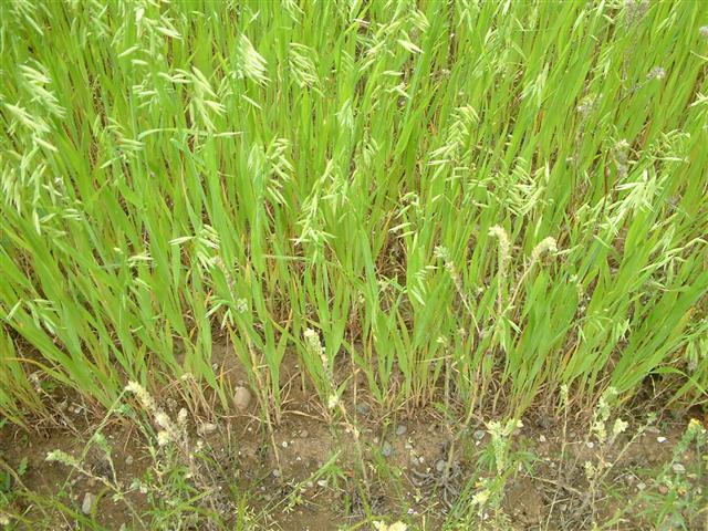

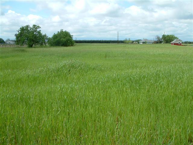

The topsoil is thin so I used an offset disc with a tire drag to till the top 4 inches of soil. I planted Kanota oats.
