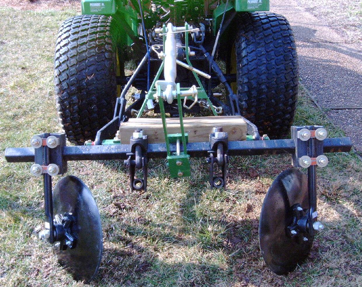

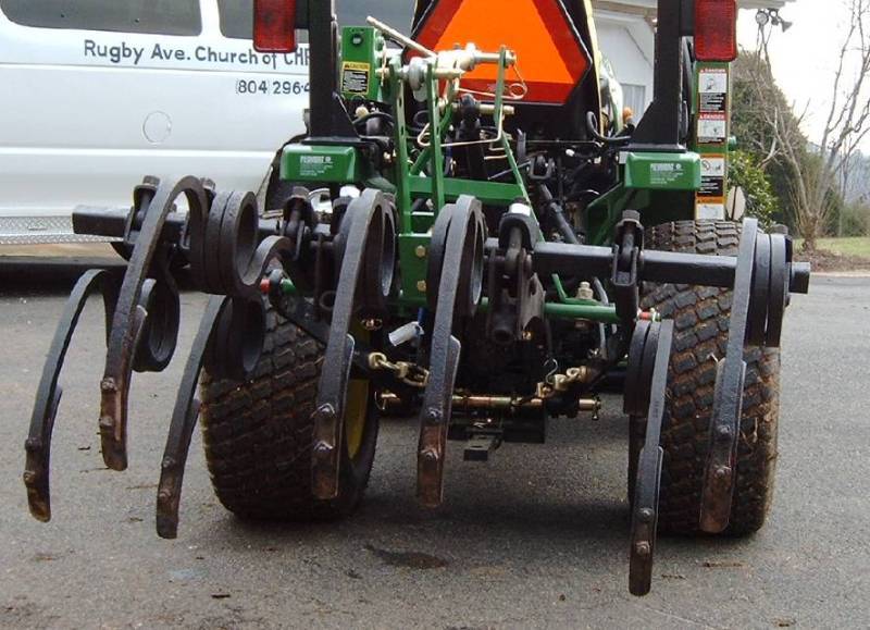

I had a JD 4010 (like a JD 2019E, if they made them today) as my first tractor with turf tires. It was a real bear doing snow work and would pull an old JD soil ripper with the tines pretty much dunked in soil. I tore up my big garden that I had at that time. Could hit the turning brake and spin it around to the next row(s) at the end of each row, too. It's about a 1200 (raw tractor) # tractor. I had an FEL on it, which added another probably 400# and filled rear tires with wiper fluid. Plenty of traction and power for what you want to do, e.g. more like a Kubota B2301.
I put some big opposed discs onto the soil ripper bar in place of the tines and did raised rows. Would be very much like your row shaping you want to do. Pictures attached.

Those opposed discs are likely what I'll be going with for "bed shaping". Thanks for the pics.
