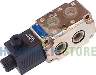

I have no rear remotes on my tractor. For now what i do for my chute on my blower i just unhook my bucket hoses " quick coupler" and hook up my chute. Its a pain in ***** for when i want to use my bucket. So i would like to hook up a selector valve to the bucket circuit and just select between my bucket and chute. So the question is what type of selector valve do i need and how do i hook it up? I also though of putting in a power beyond on my main valve and install a separate valve for the blower but i find the bit to expensive for the amount i would use it.

A one spool valve with PB is about the same priceas a diverter valve.
One thing you have to think about on a diverter valve is the the regen. You hae to use the tilt up port of the bucket.
Connecting a diverter is easy. The diverter valve has two IN ports, and two sets of OUT ports. Your bucket is the default mode.

If you chute is hyd motor driven, a regen valve might give you trouble. Regen closes off one port to tank.
You should use a motor spool valve on a hyd motor, or a solenoid motor spool valve..
If the chute is cyl operated, then a tandem center valve can be used, or a solenoid valve..
If you add a valve to the loader, it should have PB to feed the next valve.

Ok got it. It's a motor so PB and single spool valve is the answer. I probably will put a double spool just in case for the future.
