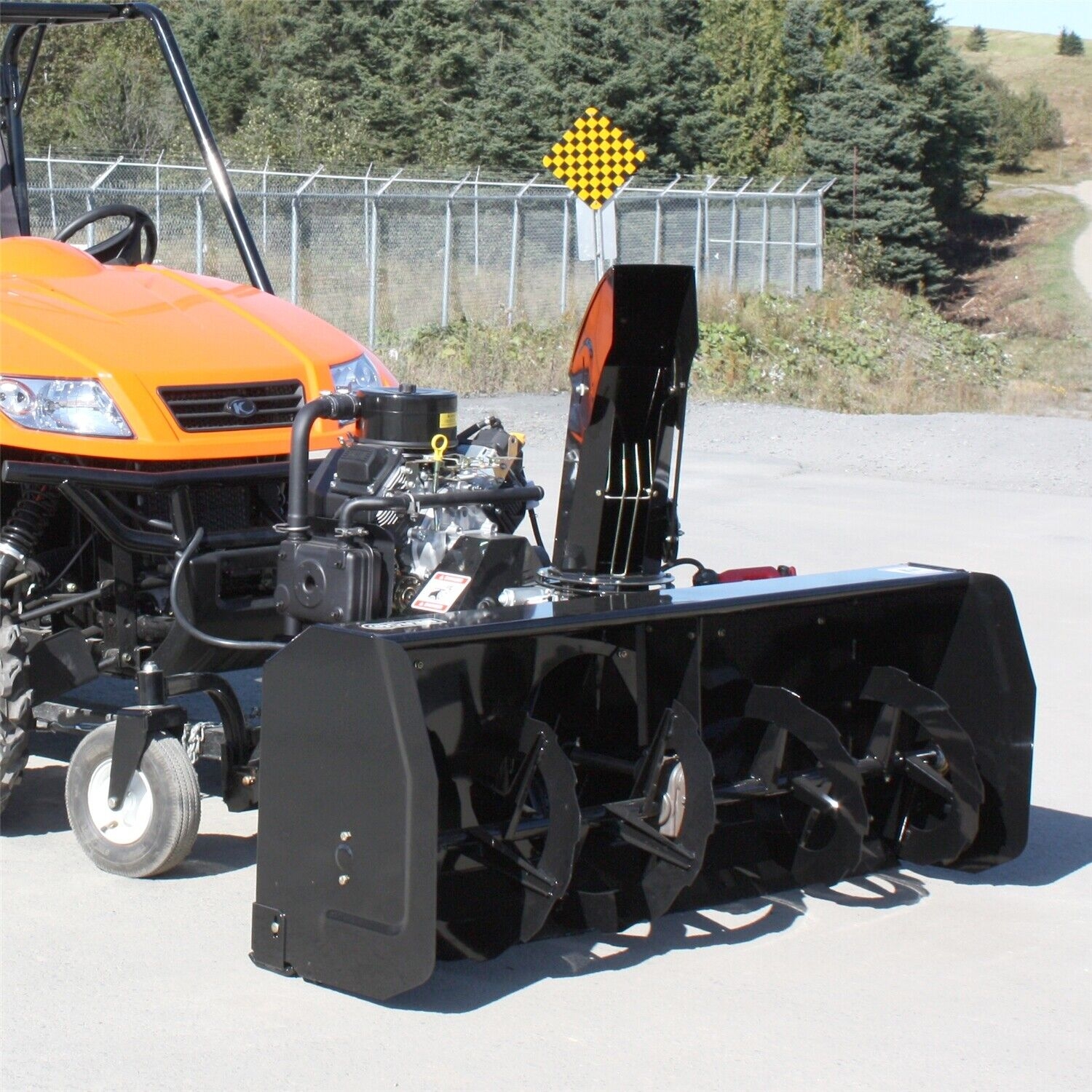

How does that sort of thing work on an ATV without lift capability? Does it just wheel along? If so, I'd imagine the maxx should be fine... as long as you don't expect to have to pick it up. From what I can see, it extends out a bit. If it's really 500#, it may be too much to lift, but if an ATV doesn't need to lift it hopefully you don't either.
   / Self powered Front End Loader Snow Blower ?
No the ATV’s uses a winch to lift it, then it resets on a set of wheels attached to a frame. Don’t forget my emax has a lift capacity of 618 lbs.

Is this it?? Seems they are a light build but I've not used one. Do keep us posted.

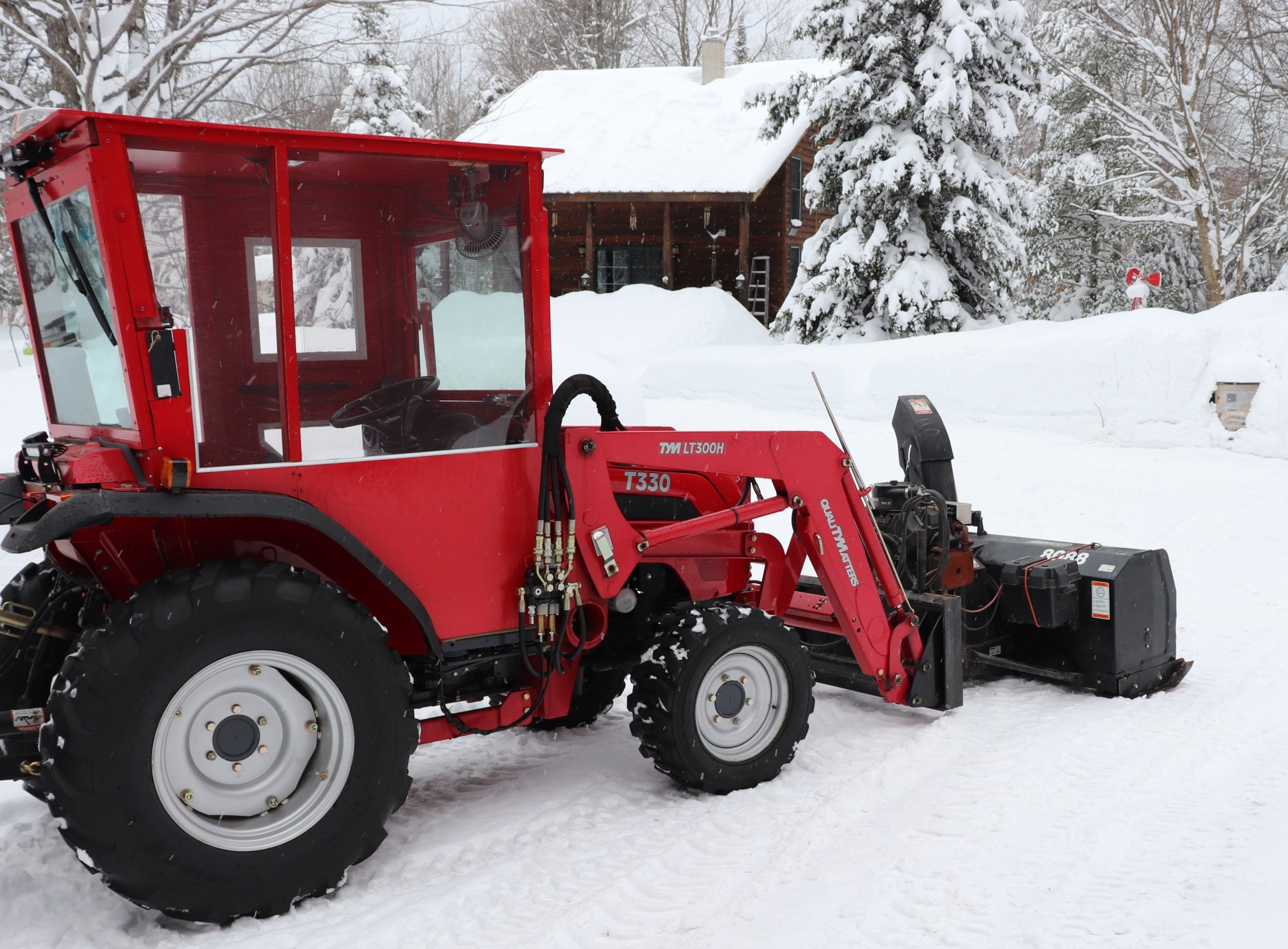

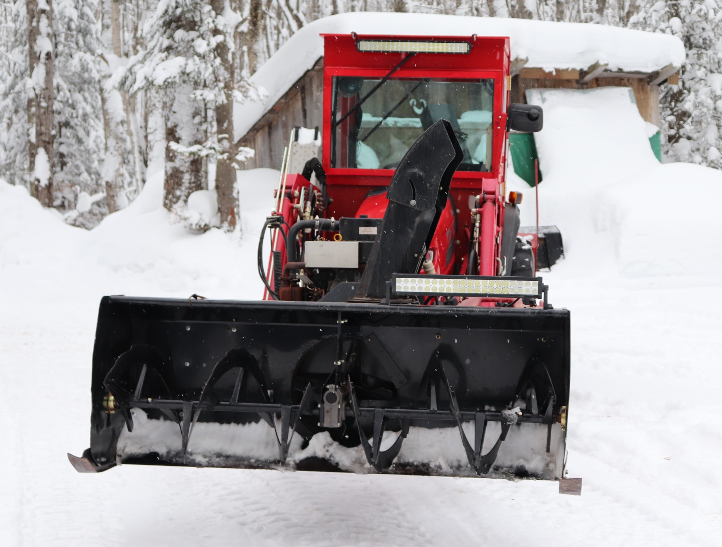

I had the 60 inch 27 HP. Kohler model on my old TYM T330 and I don't think it weighed any more then 500 lbs. It did blow snow really well. I think you will be happy with it.

I believe it will definitely throw the snow, I’m just worried about the weight. Your tractor seems much bigger than my emax 20. Well, I’m gonna give it a shot. Thanks

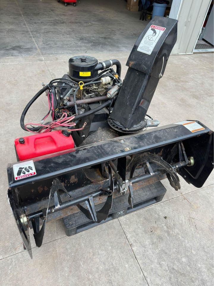

Here one on For sale on Facebook in Calumet MI.
ATV/UTV Snowblower​
$3,500
Listed 3 days ago in Calumet, MI
Details​
  • Condition
    Used - Good
48” Bercomac two stage snowblower with 23hp Kohler engine. Has upgraded high torque clutch and improved drive belt system.

Yes I have the 48 inch Bercomac but it has a 20 hp Honda motor, electric shoot and rotation. That one looks like it has quite a few hours on it, mine looks brand new and only has 4.5 hours.
