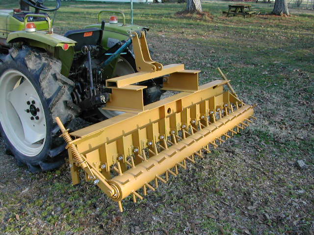

I have a Lincoln Weldpak 100 and I have been very pleased with it. I have welded thin sheet metal successfully and welded heavy duty thick material with multiple passes with great success. I got mine for about $300 + tax at Home Depot. Attached is a project I built with it.
