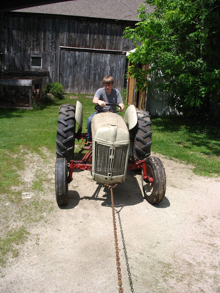

Can anyone help me figure out a fair price for this tractor? I know nothing about it, other than it's a late 1940s (based on info from previous owner); loads of new parts/paint. haven't tried to start it yet (has been sitting in the barn for a few years).
All original manuals and service records available.
Need to sell it to make room in the barn.
Thx
pf

pics would help, but if it is in decent shape and will run i would say $1500-$2000. thats what they fetch here in my neck of the woods. if its a 40's model, it might be a 2N.
   / Selling Ford 8N (1940s) - what's it worth? #3
A '40's model could be ANY of the N seires.. 9n, 2n, or 8n... 9n thru 41, 2n thru 47, 48-52 for 8n.
soundguy
   / Selling Ford 8N (1940s) - what's it worth? #4
Thx
pf
look on the engine, left side.. above the starter.. blow the head, aft of the oil canister.. you will find a 1x4 flattened boss with extremely light hand stamped sn. all 9n/2n start with 9n.. 8n start with 8n.
be advised that any N engine will fit any N chassie.. this includes industrial N engines made for gensets, water pumps and early jeeps / delivery vehicles... so you can't go on engine sn unless it appears to agree with other age related markers.. like radius rod design, trans.. etc..
post pics and the sn.
soundguy

Thanks for the replies - attaching a pic, will take some more tonight showing more of the tractor. Will also poke around for the serial number to see exactly what model it is..
Cheers.
pf

The red paint, floorboards and brakes on the same side indicate it is an 8n. If the distributer is on the side , then I think it would be at least a 50 model. If it has the proofmeter (tach), then it would be the 51 or 52 and worth the most money, probably in the 2500 - 3000 neighborhood if you get it running good, 1500 - 2000, not running.
   / Selling Ford 8N (1940s) - what's it worth? #7
side pics will help id year.. as would engine sn, if it matches other chassie cues.
soundguy

In my neck of the woods, a non-running Ford would fetch something like $1250 -1500. Sad to hear that you need to sell it. But it would be to your benefit to get it at least running as it would add about $1000 to the value.
