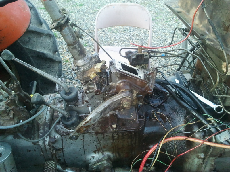

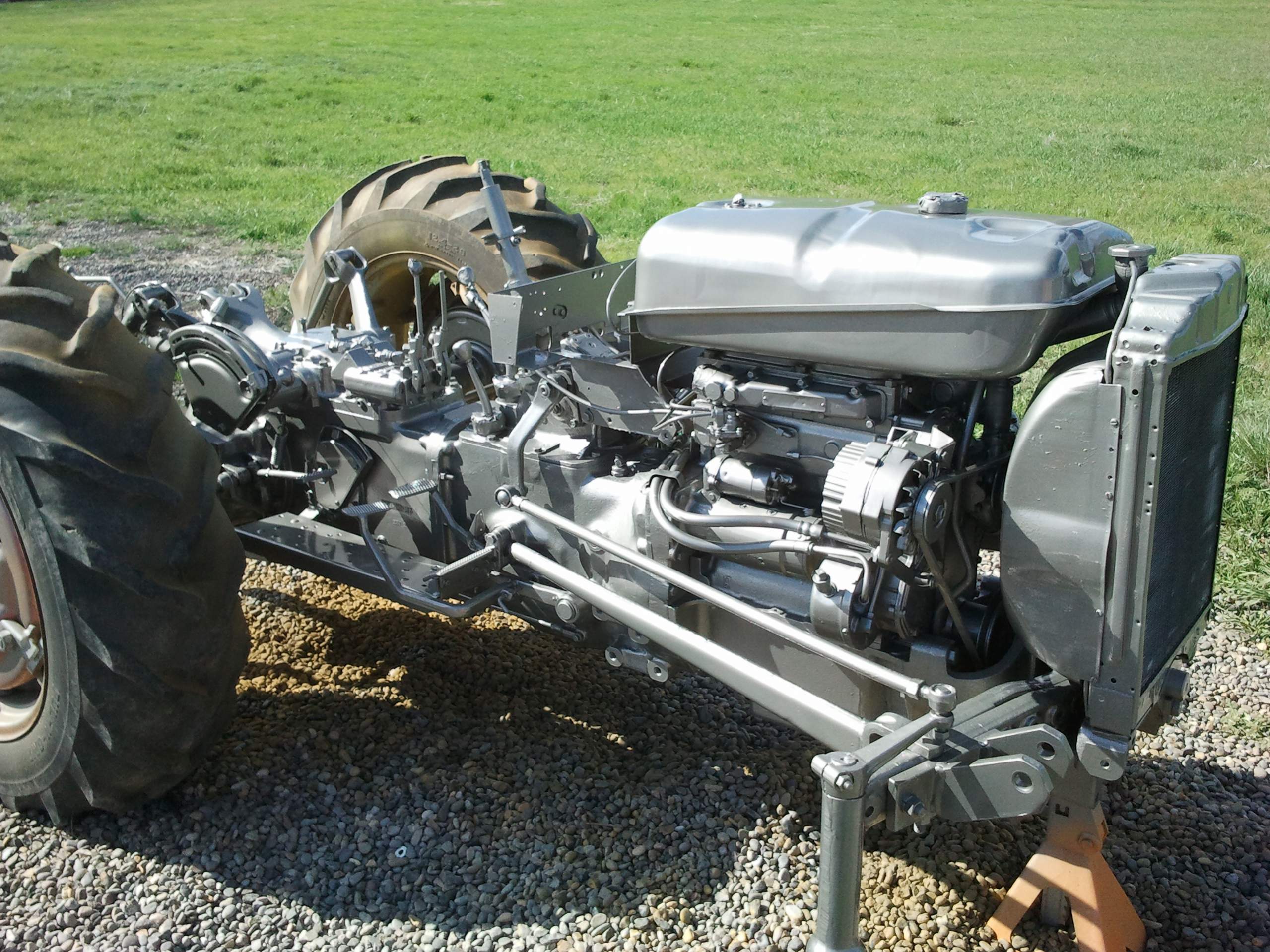

I just rebuilt the power steering box on my 135 and on the recommendation of my local dealer I made up a mix of Mobil Delvac Xtreme Service Grease and 85/140 gear oil to fill the box with. The mix is made up with one tube of grease and about a quart of gear oil. It work good.
Jim
