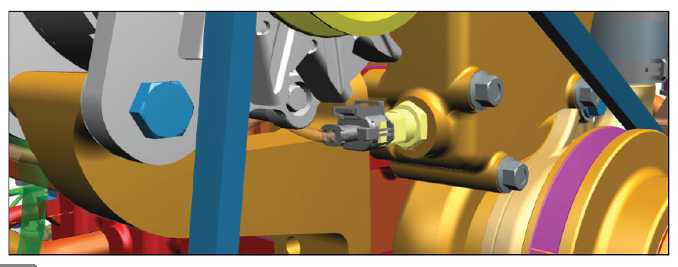

I would like to know the location of the water temperature and oil pressure sensors on my 2017 4549.
Pictures would be nice if you can get them.

There are two sensors on the thermostat housing, one is a single wire switch for over temp, the other is a two wire sensor for the gauge. The oil pressure is a switch located near the oil filter housing on the engine block(right side sitting in the seat, sorry no pic of that). coolantsensor.PNG
