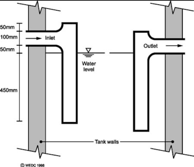

Ours is a rectangular tank with two square clean out ports/lids and was installed when the house was built in 1989. The output side of the tank has a square concrete elbow that is designed to only let liquids out into the drain field.
   / Septic / Drain Field Issues #5
Should be something like this on the inlet and outlet.

The bottom of that output elbow is way too deep. That deep and it will quickly get clogged by the sludge that builds up in the bottom of the tank. It should only go maybe 12" below the level of the outlet. The idea of pumping the septic tank periodically is to keep that bottom sludge layer from fouling the output elbow and the drainfield.
   / Septic / Drain Field Issues #8
TRUE.
you need to pump your tank before the sludge layer is up that high also. mine has a plastic filter on the output side that will clog if solids get that high.
So you are saying the drawing is “maybe” 100mm off?
And if that drawing (with unknown distance to tank bottom) were to be followed it would “quickly” clog because of that approximate 100mm difference?
