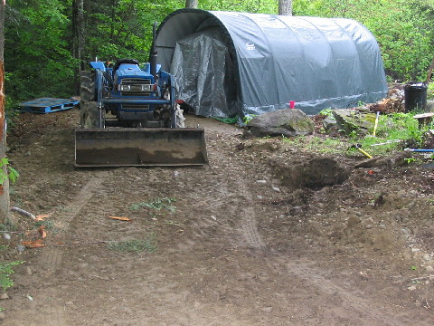

I think u so much poppa for the compliment!!!....I am truly honored!!!! Great job!!! What are u gonna do with the extra $388.00!!!!!!!!!!!!!!! Oh what a feelin!!! /forums/images/graemlins/grin.gif /forums/images/graemlins/grin.gif /forums/images/graemlins/grin.gif
I finished the quonset hut site last night and the better half is elated!!!!...Funny how we can be up to our elbows in S@@@ and come out smellin like roses!!!!!!!!!!!!!!!!

WHERE THE H@@@ ARE THE PICS!!!!!!!!!!!!!!!!!!!!!!!!!!!!!!!!!!!! /forums/images/graemlins/confused.gif

SEE HOW WONDERFUL IT IS TO HAVE THE PICS TO TELL THE REAL STORY!!!!!u better have a pic of u covered in s@#$ if u didn't take any of the whole project!!!!!!!!!!! /forums/images/graemlins/grin.gif /forums/images/graemlins/grin.gif /forums/images/graemlins/grin.gif
