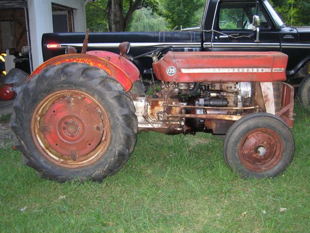

Where can I find the serial number for this tractor? I don't know how old it is. I looked on the steering column and its not there. Where else can I look?

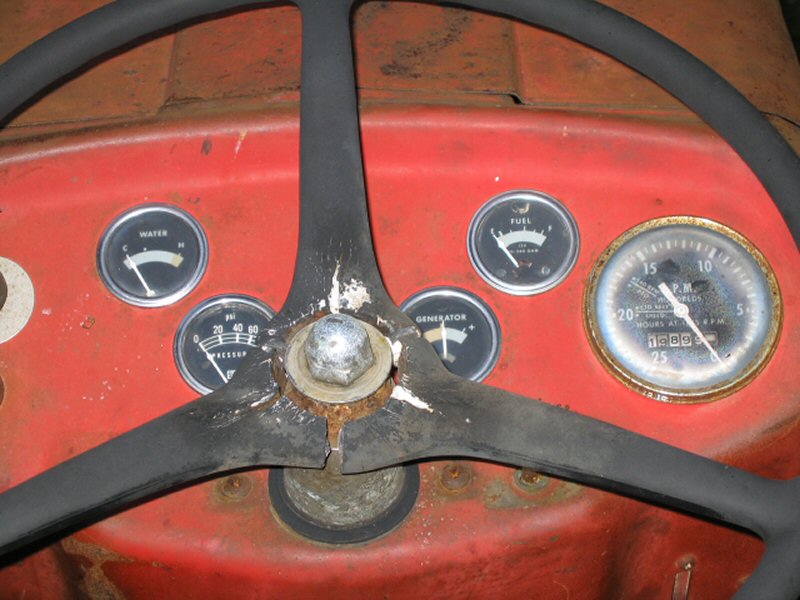

The serial numbers on the MF135 is on a metal tag about 2 x 3 inches It will either be on the dash on the left side. The early ones had it under the hood on the battery tray on the right side by the air cleaner. Prior to 1967 the serial number started with 641 1967 and after they start with 9A Hope this helps

Here is a pic of the dash. I think it (the tag) has been removed.

Your 135 has a vertical air cleaner. That indicates it is an early production unit. It was assembled in 1964 ,65, or 66.
