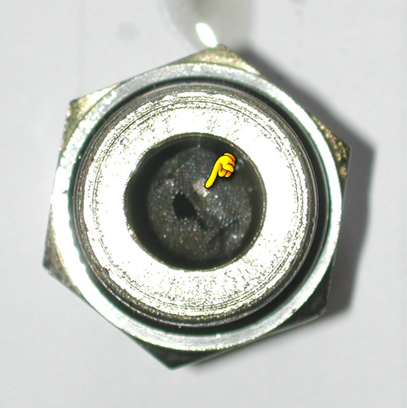

I just checked my JD 4300 rockshaft filter and there was a hole blown thru it (55 hrs). Looks like someone drove a scrrewdriver in the screen. I called my local JD dealer and they had never heard of this rockshaft filter and they could not find it on the computer. The Service Manager had no idea what I was talking about. I called John Deere's toll free number and talked to someone who gave me a part number after about 1/2 hour of looking. He said it was LVA12302. Could someone verify this. He also said the new 10 series tractors have been re-designed with a new filter assembly. Does anyone know of retrofits for the 4300 tractor?
