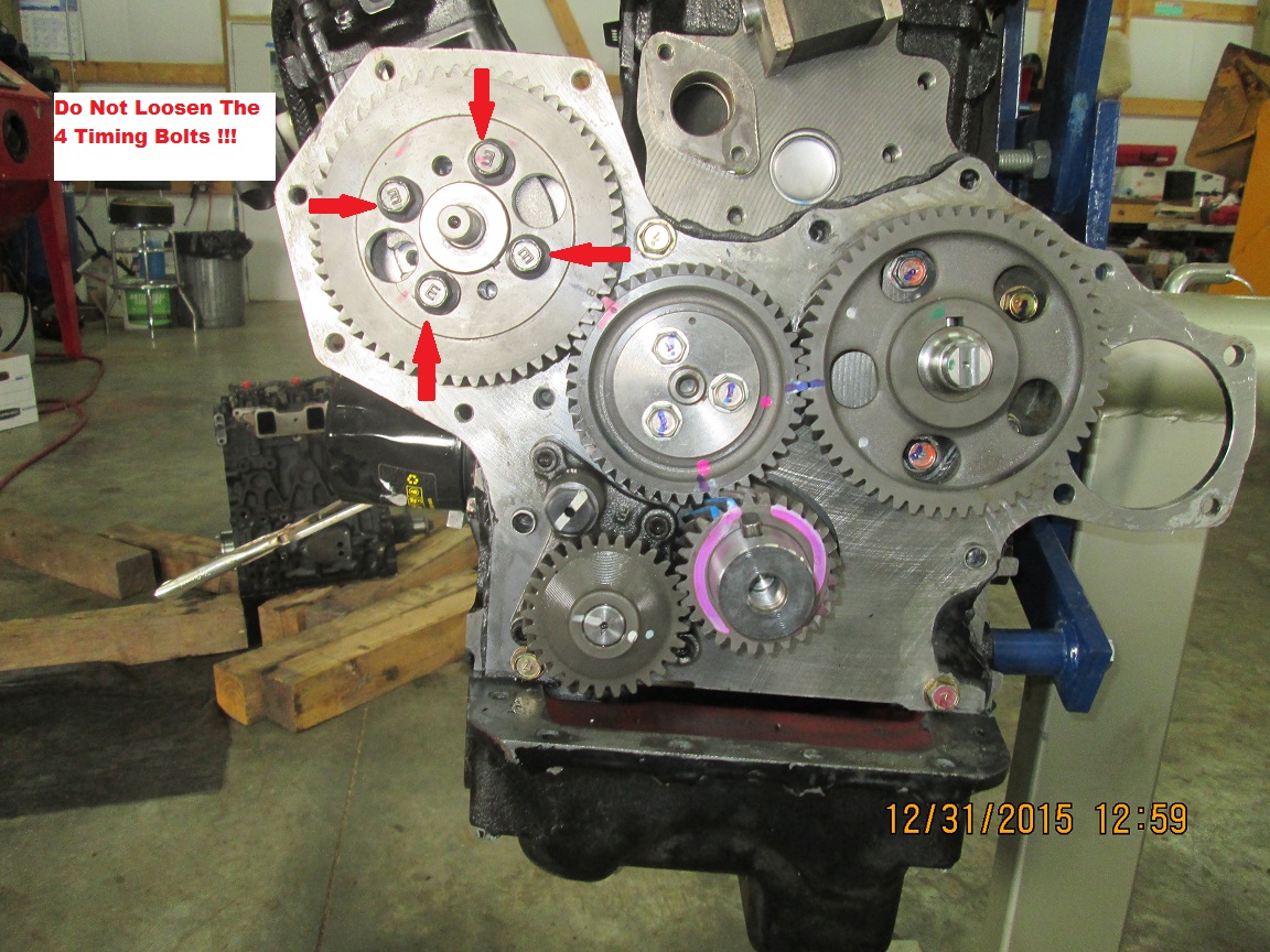

Great post!!! I did exactly what you're not supposed to do when rebuilding a John Deere 3320 engine (Yanmar 3TNV-88).......I loosened the timing bolts!!!
