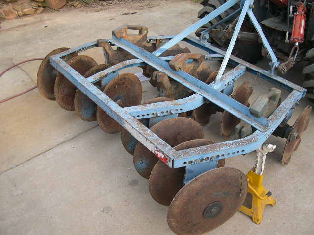

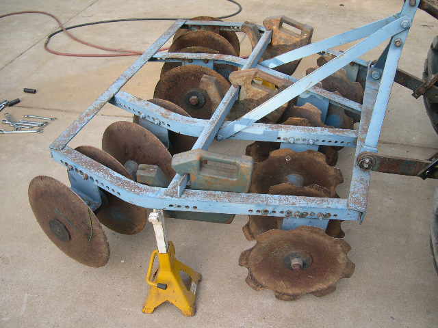

How do you set up a disc?
My Dad got a 5' disc with an old 9N Ford he got. The disk looks newer, but I have not found a brand or model number. We tried pulling it behind the 9N; it didn't "disc"; it just ran on top of the ground(even loose dirt).
The front set of discs were set straight across, and are the scallopped type. The back set are plain, and are set so the outside ends are forward of the inner ends.
We tried putting 150lbs or so of concrete on it; it still just ran on top of the ground.
I put it behind my Kubota. The same thing... I tried shortening and lengthening my toplink(TnT) with no real affect. I just tried setting the front discs so the ends are forward; that had a little affect, but not a lot. I also added three 55lb suitcase weights.
There are 12 holes on the inner and out mounts, on both the front and rear disc sets.
I do not know if I need to change the angle, add a weight box, both, or?
Suggestions?
The Disc if a Ford brand, model-205. Two pictures show the current setup

Normally, the front gangs should be more aggressively angled than the rear. From the photo's it appears just the opposite. The front looks too "straight", with more angle needed. Rear looks OK, to SLIGHTLY more aggressive than you'd need if it were digging. (Too aggressive on rear gangs and you end up with a center "ridge" where too much dirt ends up in the middle.)
That is a lightweight disc. Even with the weight shown, you still might not have enough mass there to cut in to hard ground. In plowed ground, you SHOULD be discing to the hubs.
For a first pass try shortening the top link to ride more weight on the front gangs. You can level the disc on a later pass to give a flat seedbed.

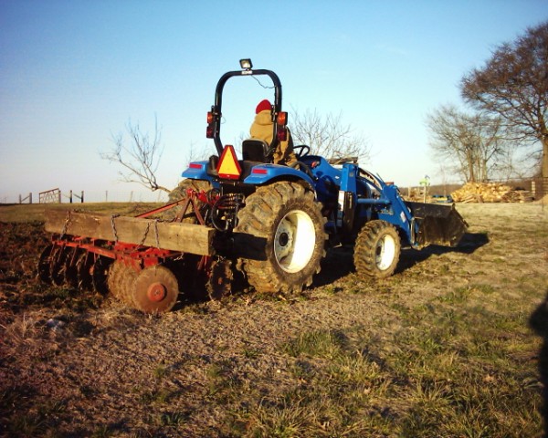

I have a light weight disc also (see photo). Although I believe it's a little wider than yours. Even with additional weight (RR tie & a chunk of RR rail) it will only scratch sod. However, in plowed ground it'll cut to the hubs. I've listened to Farm w/junk when setting mine up & for what its worth can vouch for his recommendations above.
I found that a RR tie drug behind the disc works good for smoothing & leveling. I just chain it off to the front of the disc frame.

Looking at your disc you are not far from having the max angle on the gangs and I'd say some one might have experimented with it before and found the setting to be the best all around.
The farm discs that we sell today are in the 300 to 400lbs per foot of cut for average work. By that I mean secondary tillage not primary as those discs are nearly double the weight per foot of cut. They don't normally run a disc of size off three point hitch do to the weight is a lot to hang off the three point hitch..
Your getting all that you can from your disc and to add weight will help bet be sure to add it so not warp your frame. To add the extra weight needed you should tie your frame together before you start adding so it remains level in all ways.
