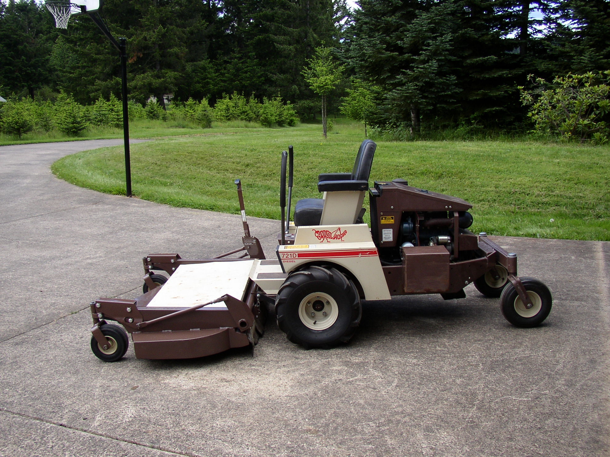

This type of mower can reach under fruit trees and will have pretty good traction with bar tires.
Our hopper was 10 years old when I bought it back in 2003 and as I recall now has around 2000 hours of use.
