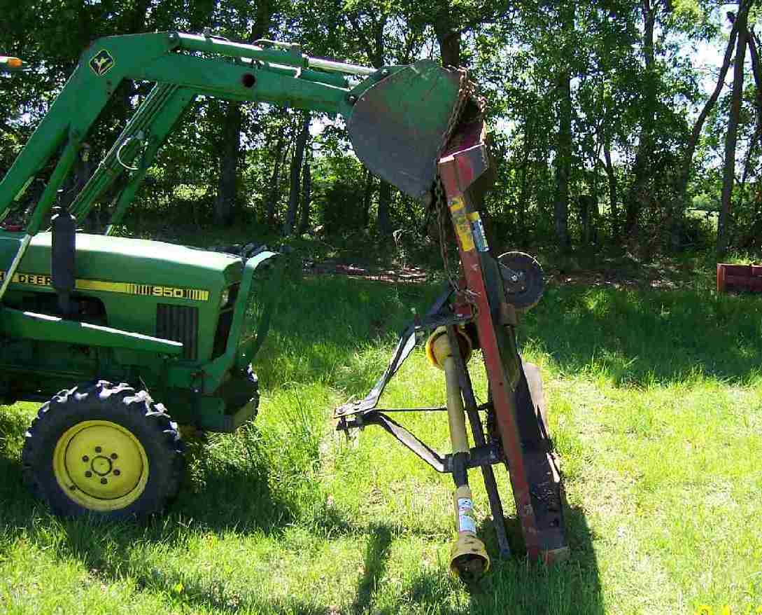

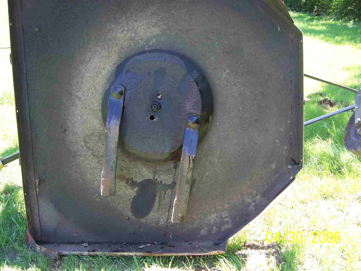

I don't take anything off. I just chain my cutter to the FEL, raise it up until it is standing it on one side leaning back against my FEL, and have at it with an angle grinder. Much easier to me than having to reach under it. And my blades typically stick to the stump jumper over the winter (pic 2) so I have to free them up and oil the pivot (pic 3).

okay my blades are considerably more boogered up than yours.. Should I just go ahead and change the baldes and start with new ones ?
   / Sharpening Brush Hog Blades #9
Most blades on 5' & 6' cutters are pretty healthy and can be sharpened many times. Personally I like a sharp edge but at a very steep angle - this gives me the cut I want for my grass plus will shatter larger stuff and hold an edge a little longer. Dings from rocks etc. won't be as deep into the edge with a steep angle too, a little easier to grind out. I use my hyd. toplink to kick the rear of the cutter up high, put a jackstand under it, then clamp a pair of Vise-Grips on the end of the blade and let it rotate against the body to hold the blade while I grind it with my 4 1/2" grinder. No need to try and balance your blades with just a simple sharpening, if you have to remove enough metal to throw your cutter out of balance to where you can detect it, it's time for new blades !!!
   / Sharpening Brush Hog Blades #10
My blades are not quite as nice as they appear in the pictures. They have been sharpened several times. But they are so heavy that I don't think that occasional sharpening is having much affect on the balance. If I have to grind one to get a notch out, I try to grind the other an equal amount. I figure when I start to notice some vibration, it will be time to get new blades.
