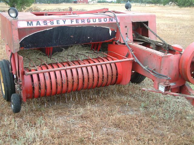

The lights and flipper came with the baler. The previous owner also installed a single action hydraulic ram on the pickup so he could make adjustments from the tractor seat.
That hydraulic ram was a neat idea. Our fields are too uneven for that setup. We normally use a spring loaded pickup with an adjustable guage wheel on the outside right. Ken Sweet

Hayfields around here tend to be pretty flat so the ram works fine.

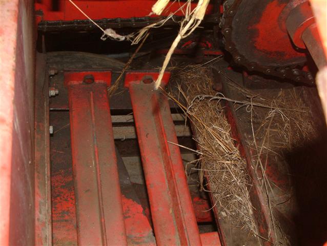

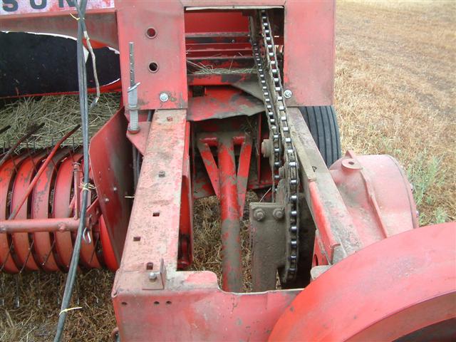

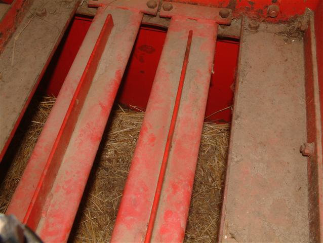

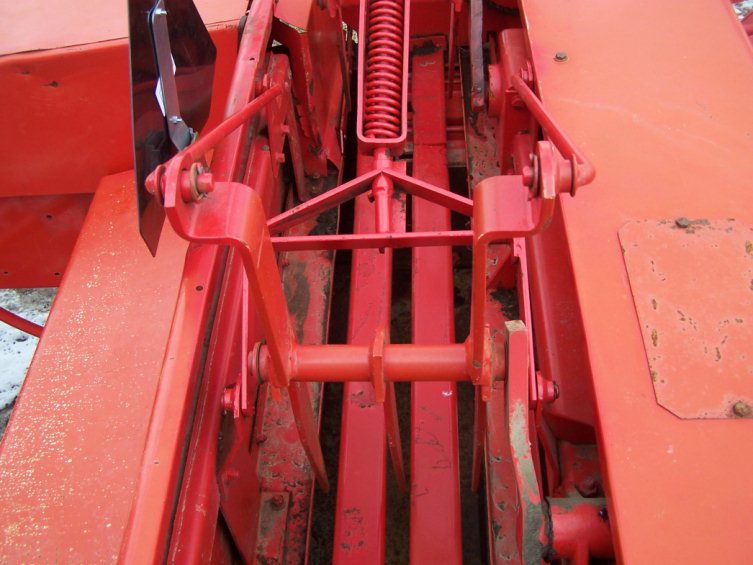

I meant to ask: in preparing your 124 did you remove the bale chamber knives for sharpening or replacement? I need to do this job on my 124 and getting access to those knives is a real hassle. You can crawl into the bale chamber from the output end to get access to the fixed knife, but it's a real tight squeeze and very uncomfortable, especially for an old fart like myself. And you can disconnect the drive arm on the plunger, retract it, and get to the moving part of the knife.
The other way I see is through the top of the bale chamber by removing the three rails that the packer forks work through to get to the fixed knife.
I've never seen anyone service these knives before so I don't know the slick and easy way to do this job.
Any suggestions?
Thanks in advance.

We did not need to sharpen the blades on this 124, however, through the top of the bale chamber by removing the three rails that the packer forks work through to get to the fixed knife sounds like the way the design was probably intended to be used. Ken Sweet
