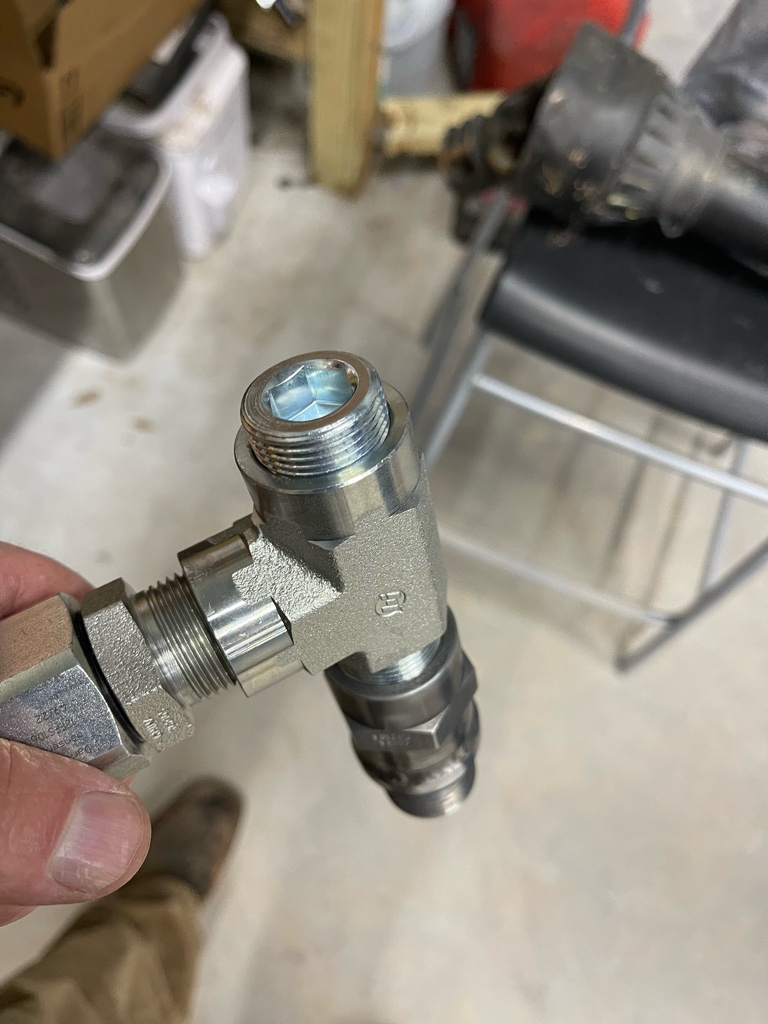

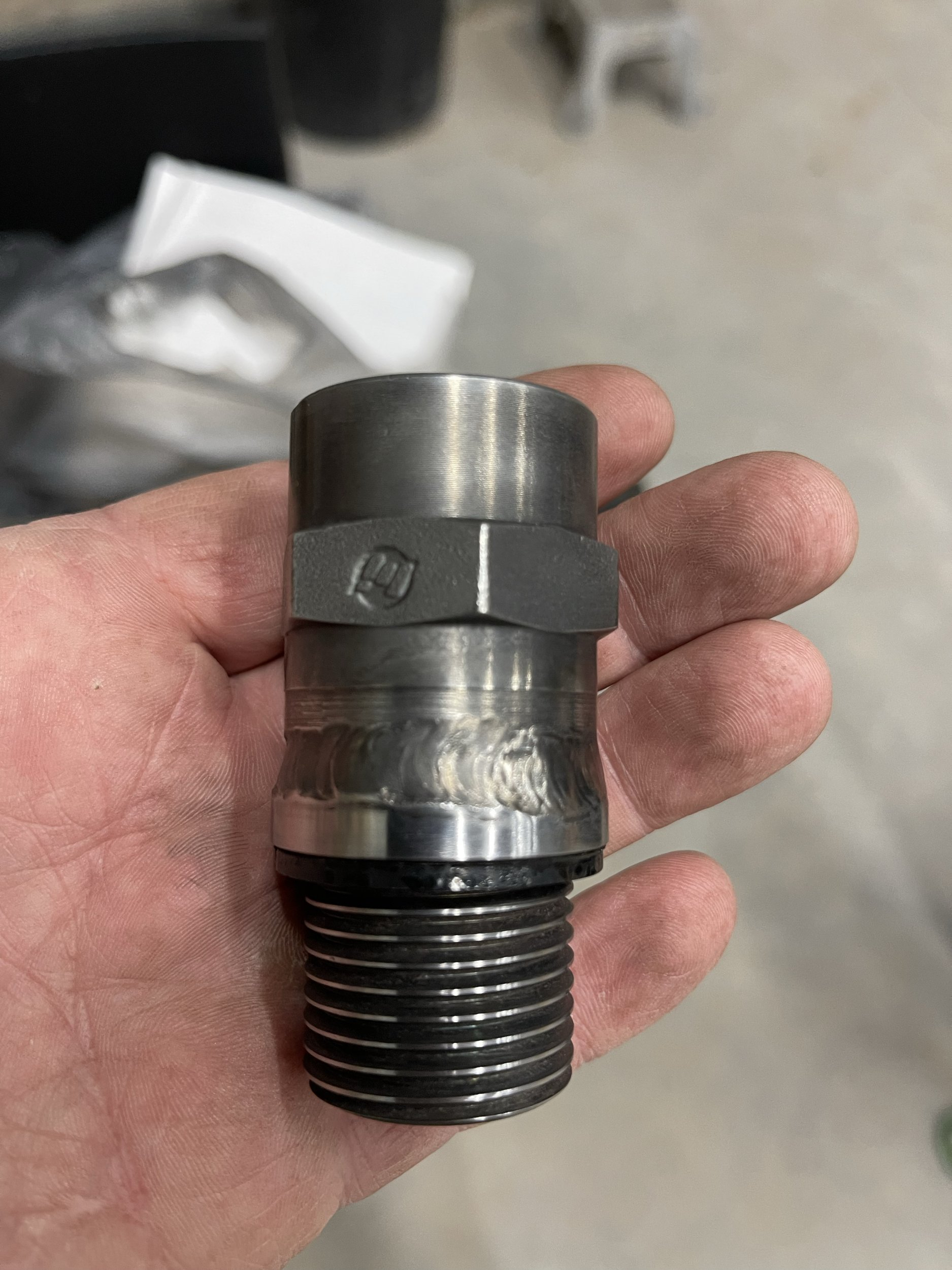

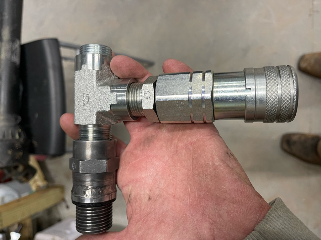

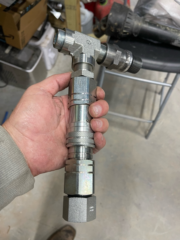

[mention]Birdhunter1 [/mention] So it’s home, I’ve now had 3 separate dealers tell me my suspicions on the backhoe hydraulics are correct but we could all be wrong .
They did not have the couplers I need though so I guess I’ve got to go on the hunt in the morning.
If the backhoe hydraulics work out this won’t be needed and I think to help everyone out I will run back by HSC next week and have them give us the exact thread and diameter that he built but here it is.
All put together this is what I had in mind.
I think this should work, I swear those hi-flow couplers are made of gold and painted silver because they are NOT cheap.
If my deal works out I’ll sell it all to you.
   / Shaver HD8 return line #17

So what it is this going to thread into? I don't plan on a coupler at all I'll just cap or plug the hard pipe on the tractor and when I need to use the driver I'll remove the cap and thread the hose in as it isn't hard and its not Like I use the thing multiple times a week or month. Usually I hook it up, pound a bunch of posts, then I'm done with it for a while.
Then all you would need is this
I wanted to put it on and leave it.
That’s a 3/4” NPT coupler threaded to go directly into the tank fill.
Like this

And you are adding a "Tee" fitting for what purpose, is the QC in "Tee" going to Shaver, if so it seems to violate the "free flow" concept....

THAT IS EXACTLY WHAT I WANT! Does it thread in tight and seal? I can even weld on my own 3/4" NPT end, I just need the part that screws into the tractor.
