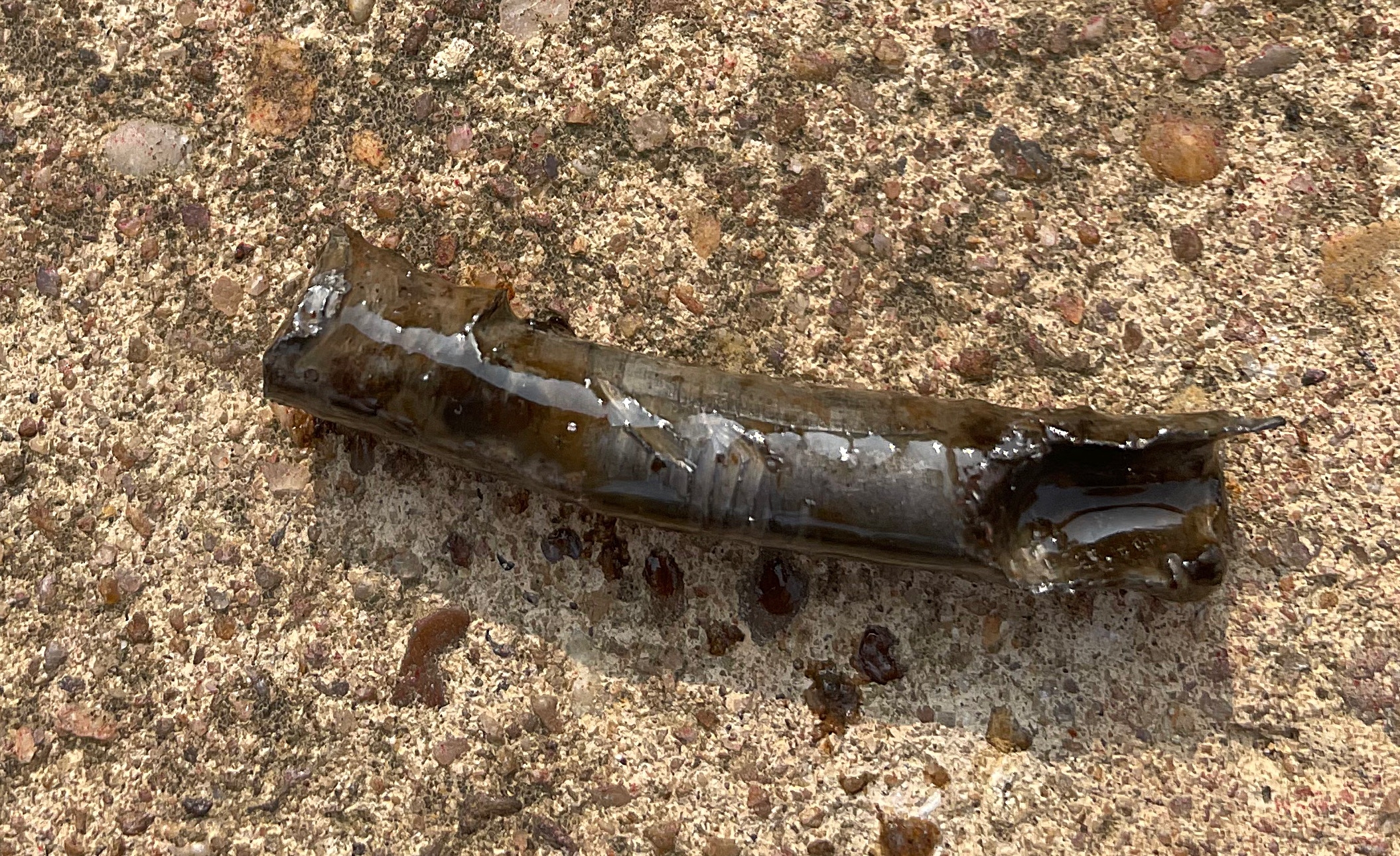

Yes, spent two hours yesterday taking out a broken shear pin. The head was stamped grade 8. Not the right stuff for shear pins
