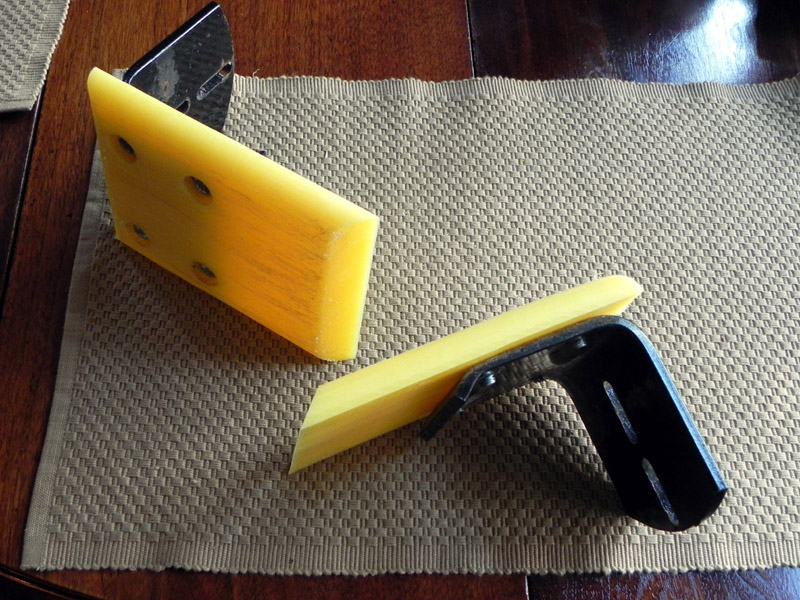

Ray, something I did on my BX2750D front blower which has back-mounted skids was to increase the size of the skid. The original was .25" thick and wouldn't stay adjusted so I added to it using UHMW plastic about 5/8" thick and long enough to go under the cutting edge. I went from shearing 6 fan bolts the first year to maybe 1 a year now. My road and my 3 driveways are gravel.
