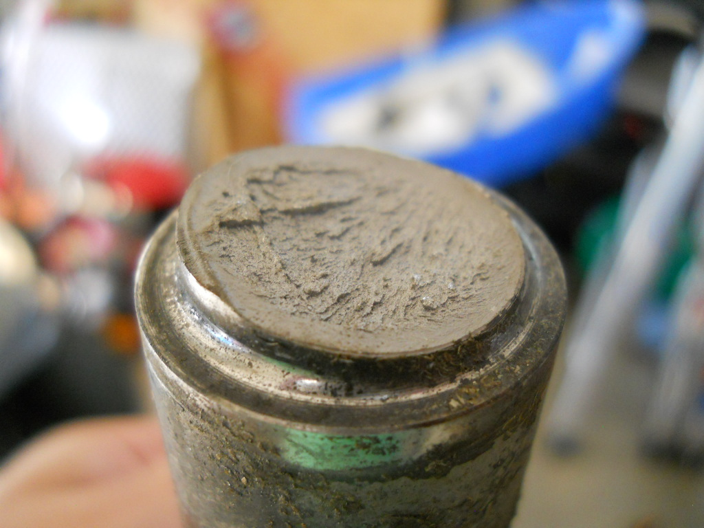

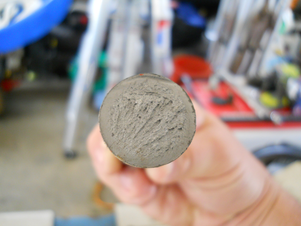

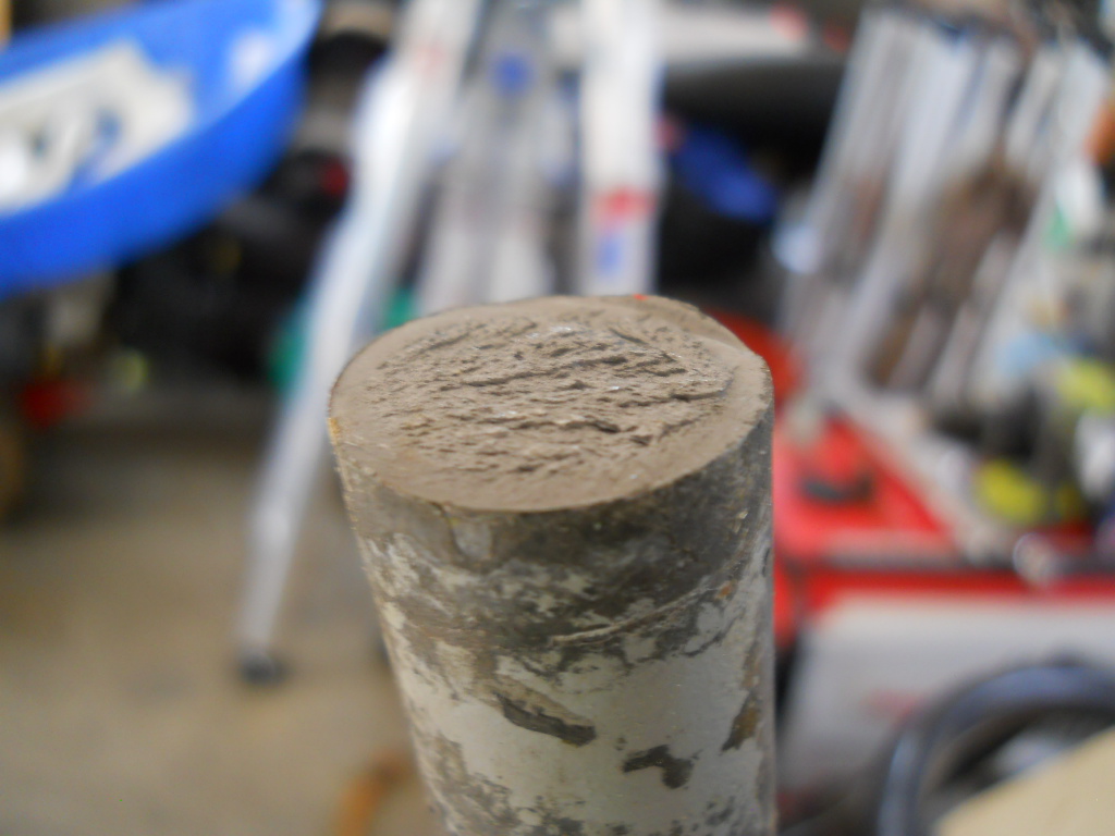

Murphy's Law hit me hard this weekend. I was pulling my 60" Woods RFM downhill through tall grass and managed to straddle a 8 inch tall x 3 inch diameter twin stump with my MT180D; my mower however slammed full on into it, bringing the entire consist to an abrupt halt.
Of all of the components of a 3 point linkage (or mower) that are easy to replace, what broke was the 30 year old, right hand end of the cross-shaft pivot (the inboard connection point for the lower lift arm). Any ideas on how much force is required to shear a 7/8 diameter solid steel rod?
I will upload pictures later (taking pictures of my fubar was not my priority), but do you think that the sheared end could be welded back on and be as strong? Anyone know of a source for that MFR. specific cross-shaft?

Shear at a transition can not be calculated.
It broke. ;-)

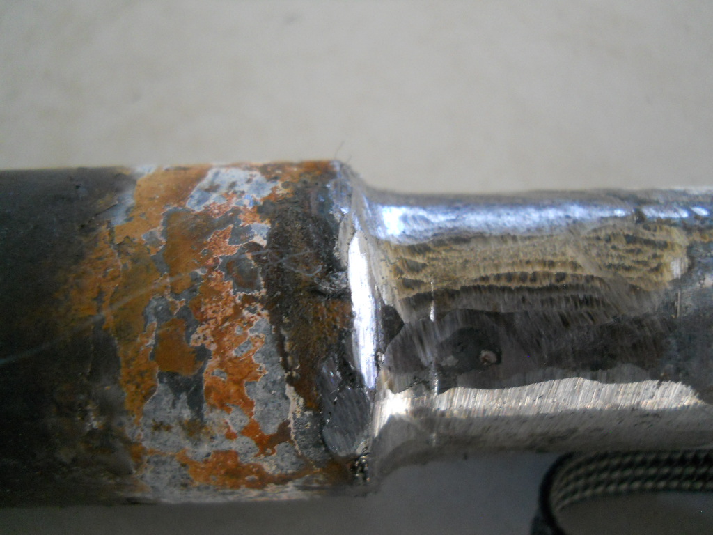

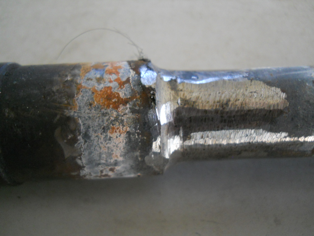

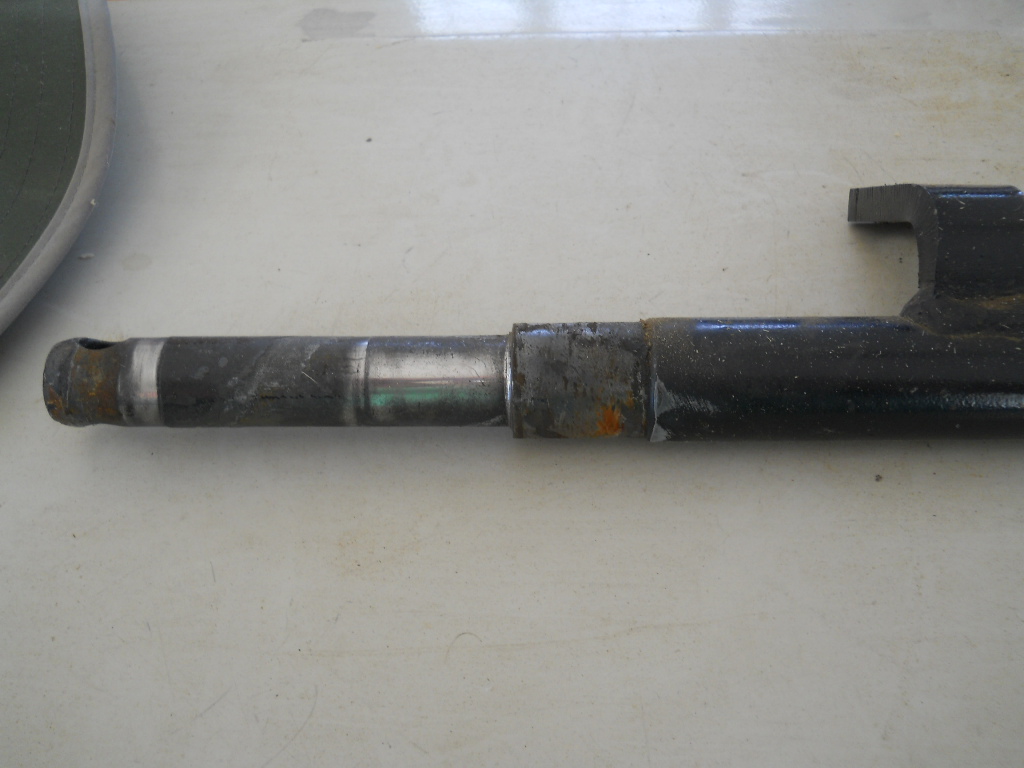

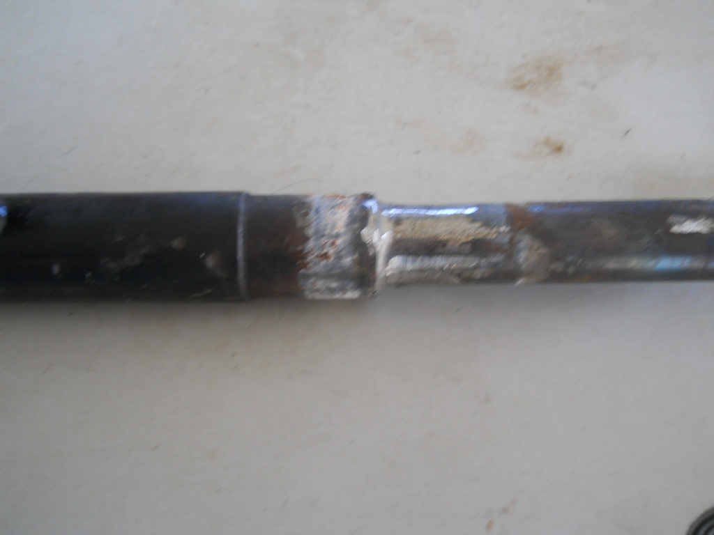

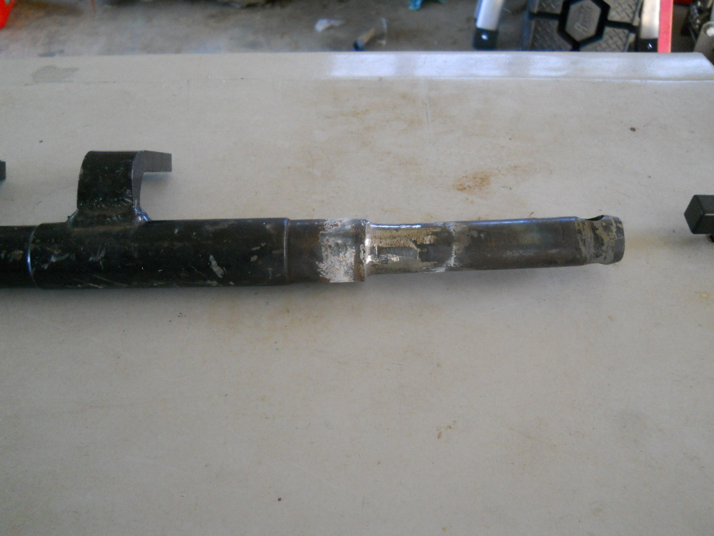

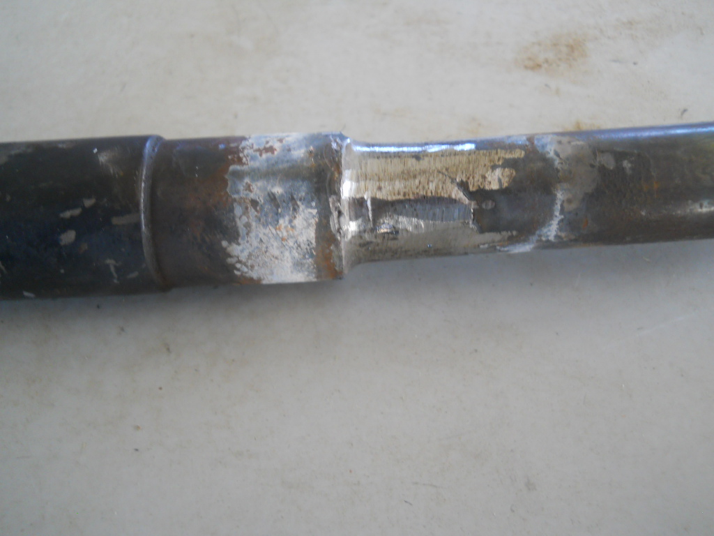

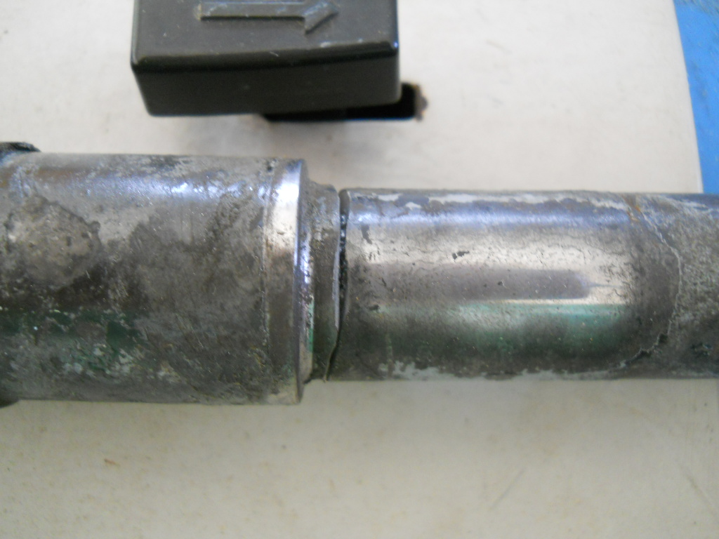

Well, I was able to have a local welder repair my flub for only $25. He stated that the joint would be softer since the original part was hardened (tempered?) steel so try not to hit anything else. I put the tractor back together and have mowed about 6 hours since without issue. I'll admit I have been a bit more timid than in the past.
Here's some pics of his work:
