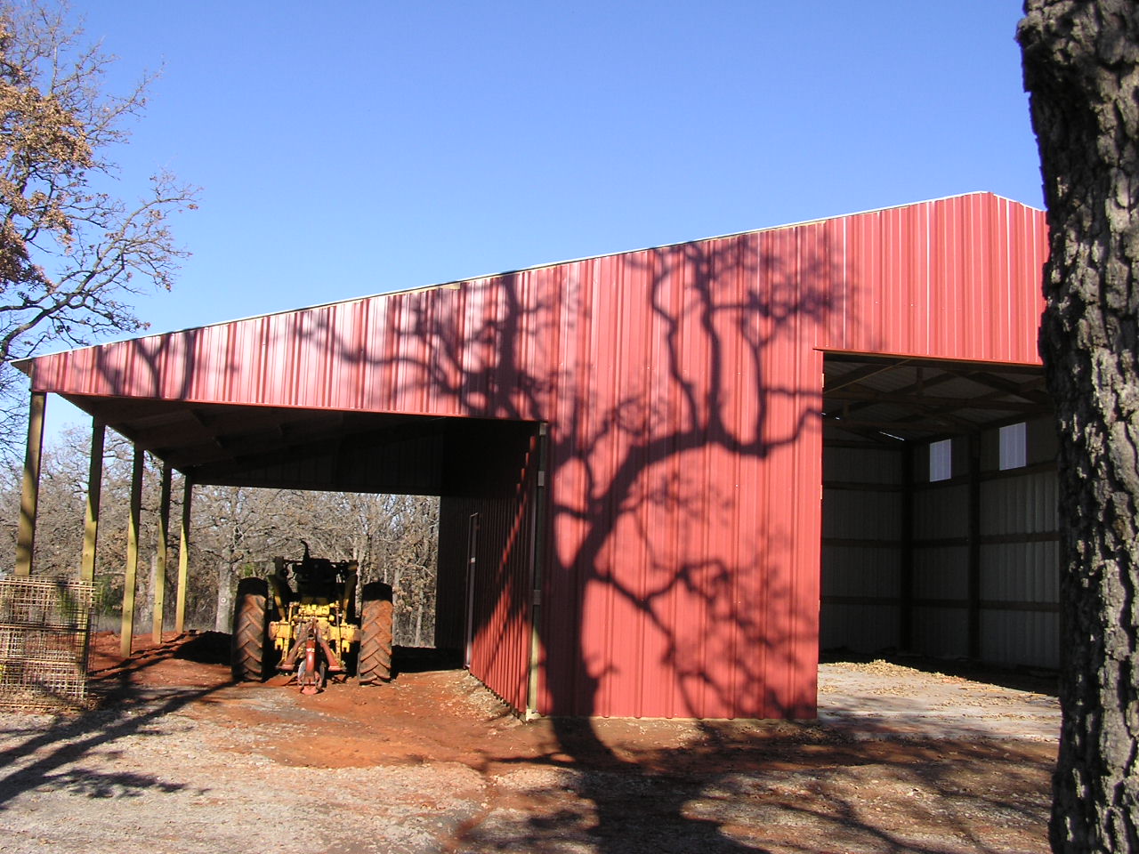

On a single slope shed roof, do you think 3" sheet overhang on the top and bottom would be ok? Or to much? I can get the 14' sheet in stock, if i go with less overhang I would have to special order. Not planning on putting gutter on, thanks for any opinions

Yes, 3" overhang would be just fine.
   / shed metal roof install #4
perfectly fine up to 5" or 6" without extra support double screw between ribs on top and bottom

I just measured the shed overhang, it is 6.5 inches.
Pictures from when it was being built 6 years ago:
thanks, nice barn pictures, I installed the sheets at 3 inch overhang looks good i am happy with it
