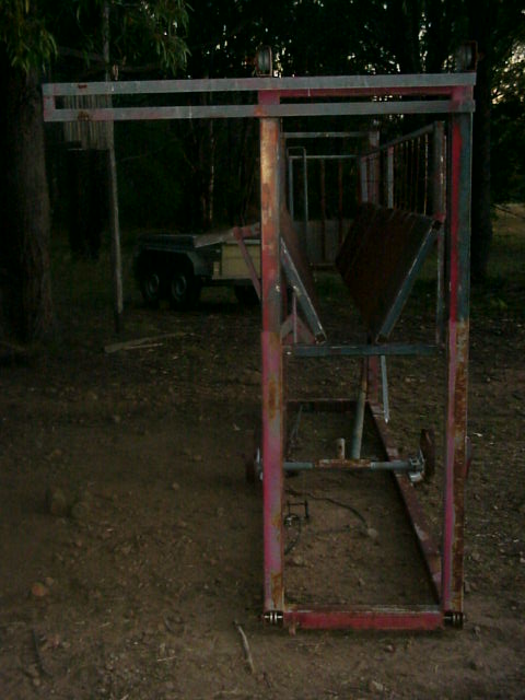

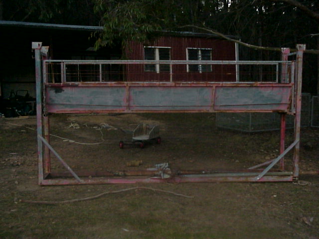

I bought this the other day for AUD$350. It's about 16 feet long and 10 foot high. Now I'm in the process of renovating it with a new coat of paint and some stragically placed grease.
Side view.

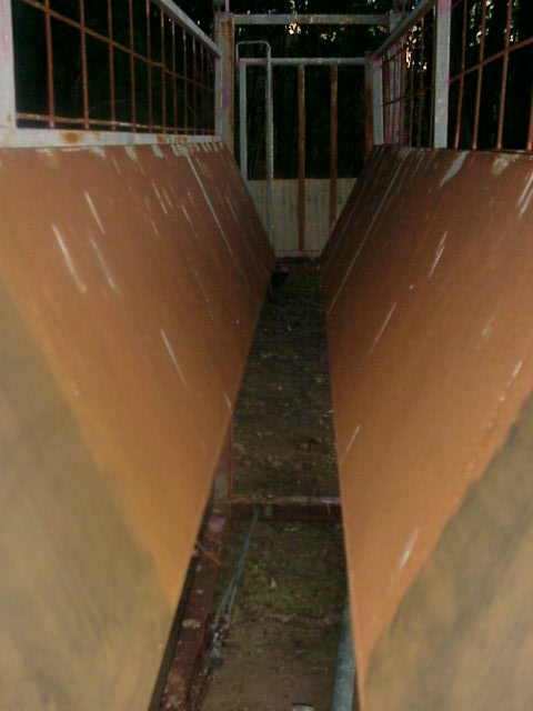

It uses a hydraulic cylinder to pull cables that lift the centre cradle.
Cradle

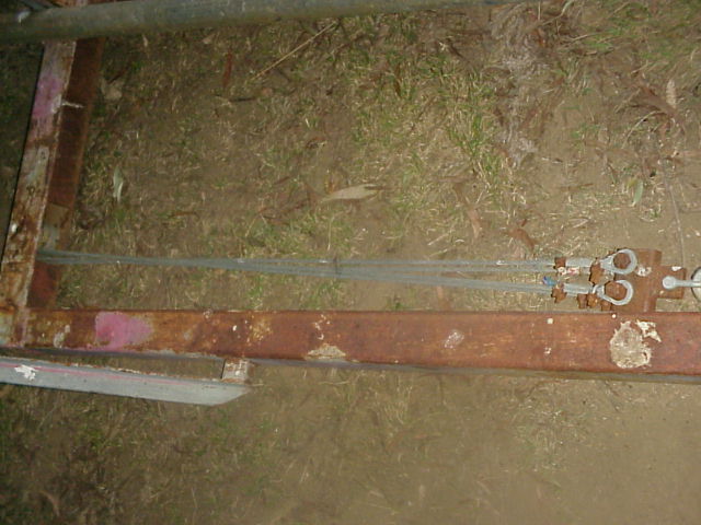

   / Sheep Handler
Cables

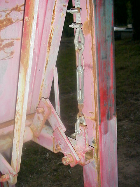

   / Sheep Handler
Cable adjustment and lever action.
   / Sheep Handler
End.

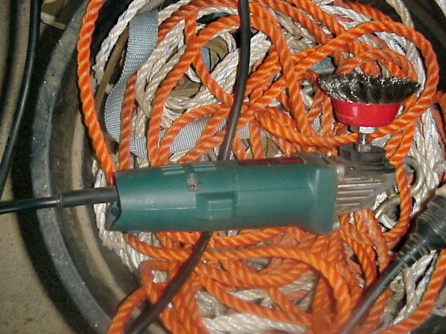

I've been using this to remove the rust and old paint. Very tiring work on the arms and a bit dangerous when it kicks back.

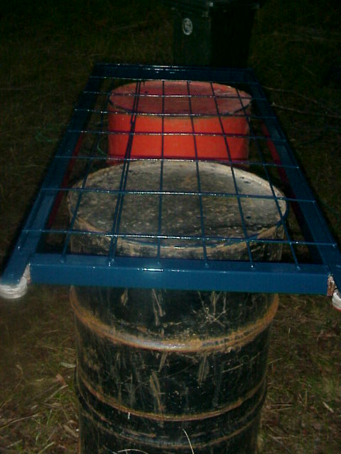

   / Sheep Handler
Progress so far. Nice shade of blue. I reckon the goats will love it.
