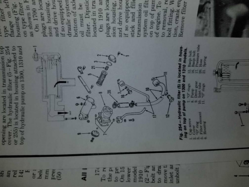

This is the style hydraulic filter on my 2243, bit of a pain in the butt to get the filter out and I'm currently trying to find a new filter, I did a Google search and found a free download of a shop manual for a Ford 1710 that has a lot of the same info. 1574553398189.jpeg1574553645222.jpeg
