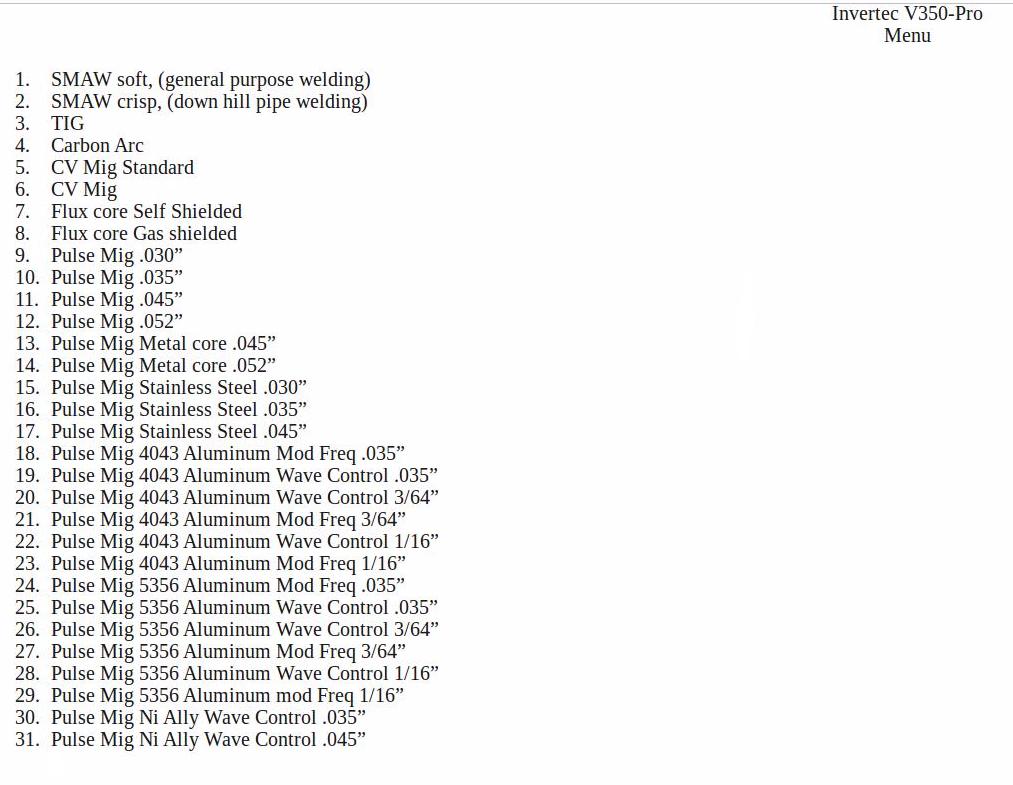

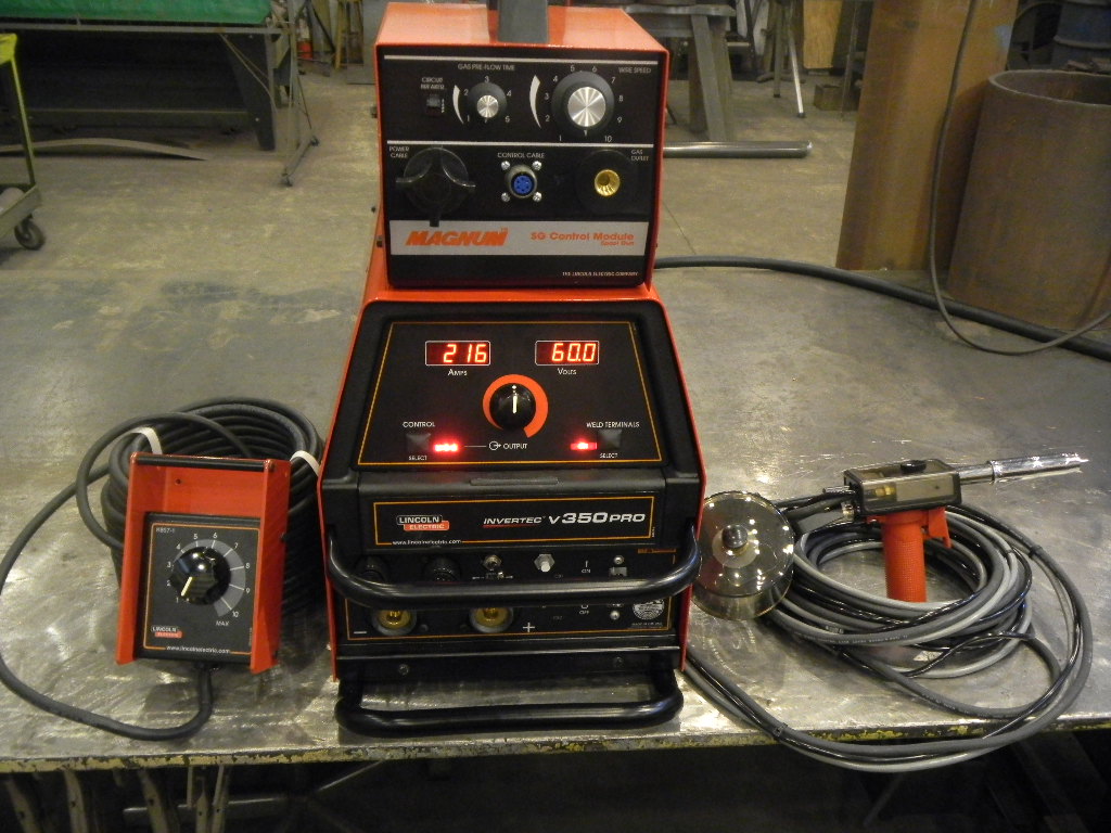

I know you have a Magnum SG spool gun for your V-350 Pro and was wondering how it's hooked up. I tried looking online and it was useless and Lincoln tech support was closed for the day. I called Lincoln in Calgary and the idiot there gave a sales reps number. It should take 10 seconds to find what spool gun works and what is required to hook it up. I did find the Magnum SG listed as the spool gun to use with a V-350 Pro but I don't know if you need the Magnum control as well. Lincoln doesn't even list a spool gun as an accessory for this machine but I know it will run one. Very frustrating.
   / Shield Arc...V 350 Pro spool gun hook up? #2
Oh wow, it's been so long now:eek:. With mine you just plug in the SG control Module. Gas hose, and spool gun. Then go to the menu for what size wire you are running. Set the volts, and wire speed, and go!

Perfect :thumbsup::cool2: I thought you might need the SG control module but wasn't positive. Why it isn't listed on the V-350 Pro brochure or the spool gun hook up chart is beyond me.
