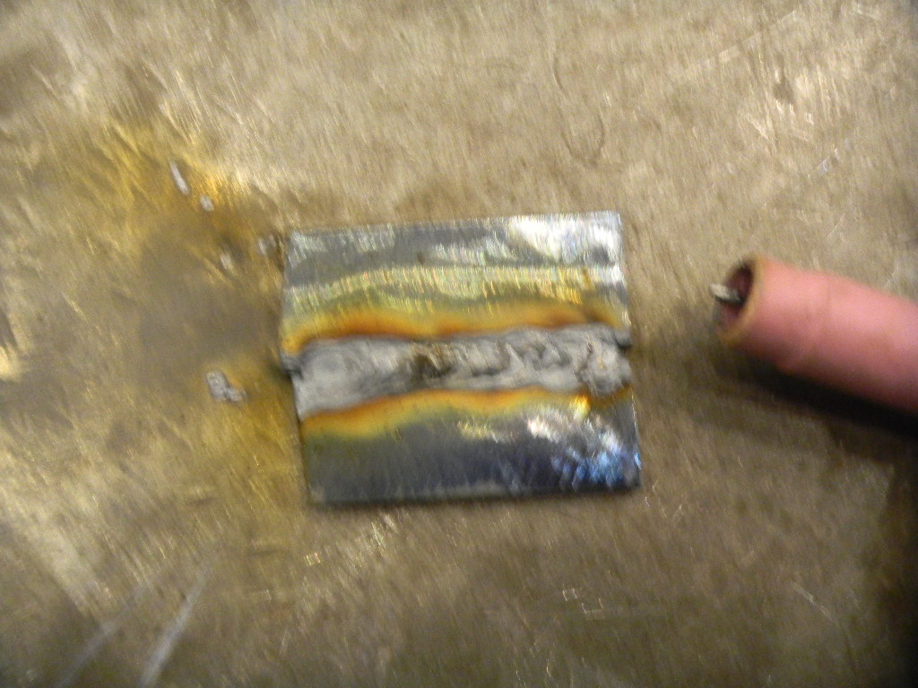

I am going to try some scratch start tig and I was wondering if I can use the 75/25 mixture from my mig or do I need 100% Argon? My bottle is empty so I have to get it filled either way. Thanks

You need 100% argon.
Here's what Tig welding on steel with C25 looks like.:eek:
