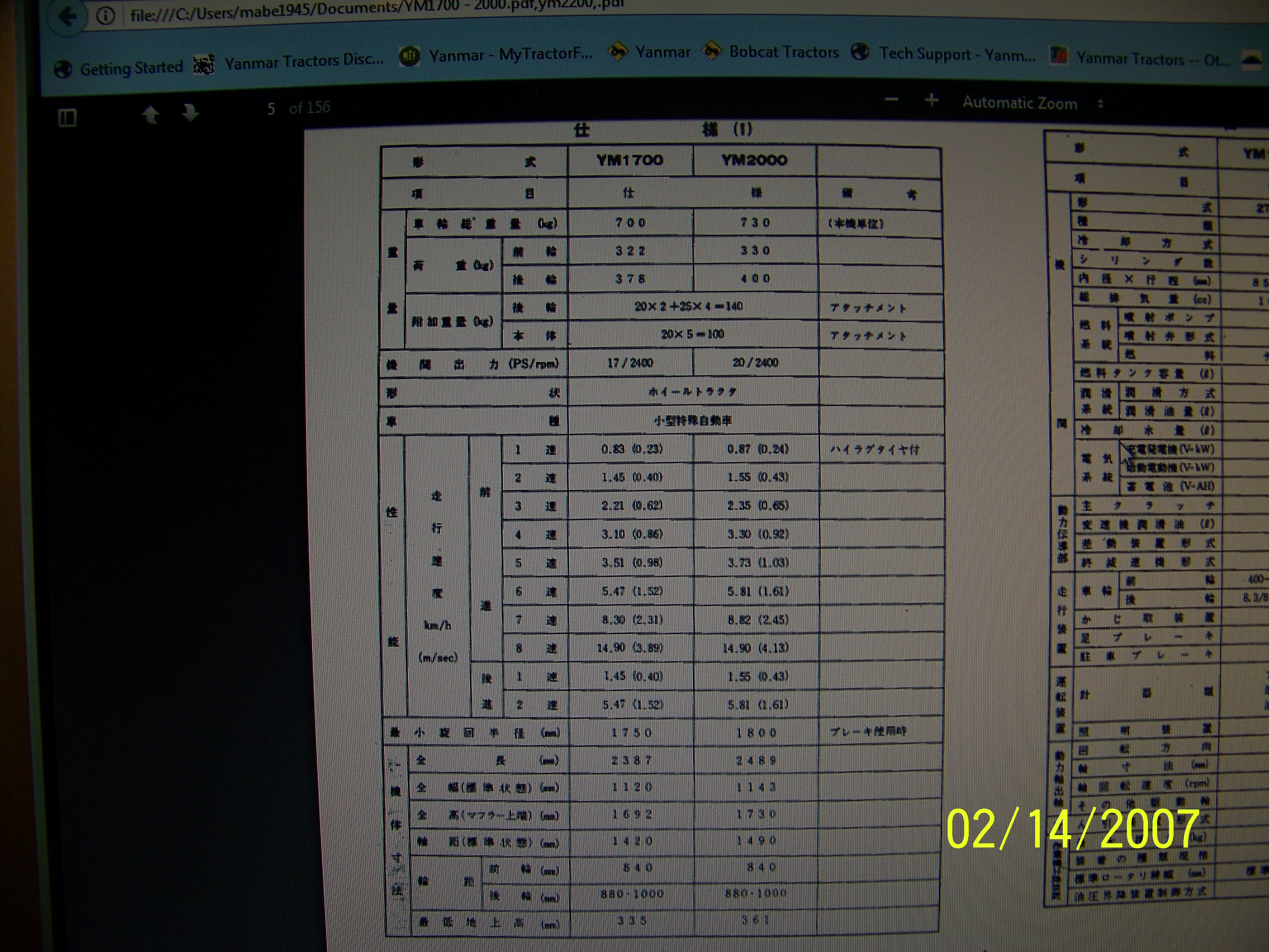

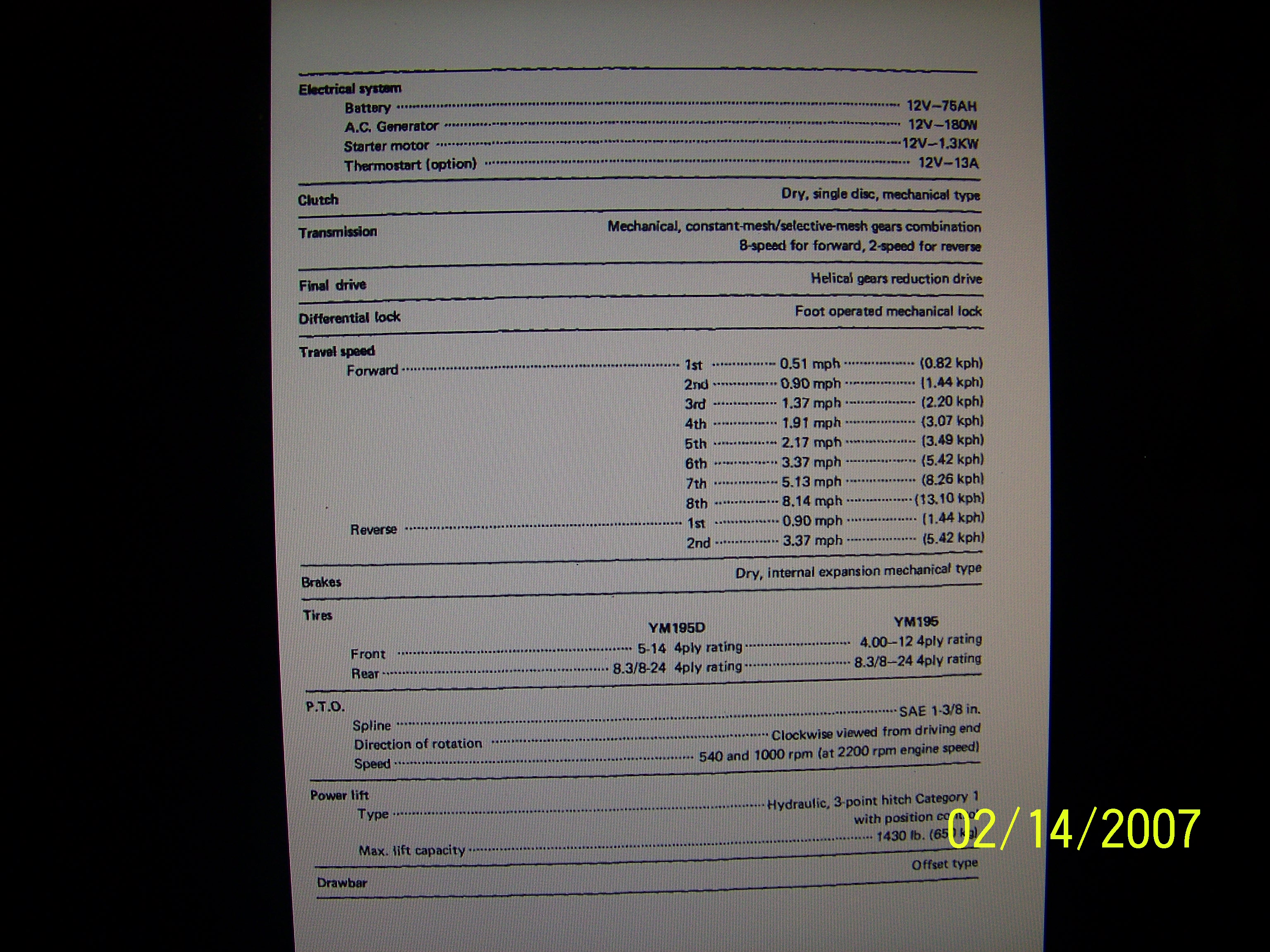

I find this interesting. A page from the 240 parts manual and a page from the 1700/2000 parts manual. Notice the different speeds. I wonder if engine speed is different between the 240 and 1700/2000? I always assumed the 1700 and 2000 had the same gears but evidently not.

Messed up again. Didn't even notice the chart for the 1700/2000 is meters per hour so if translated to mph it comes out real close to the 240, maybe difference being in engine rpm. Don't know why I get myself tangled up with stuff like this. :confused2:
   / Shifting problem #10
Yea I have the 240 service manual. It lists the ground speeds etc.
