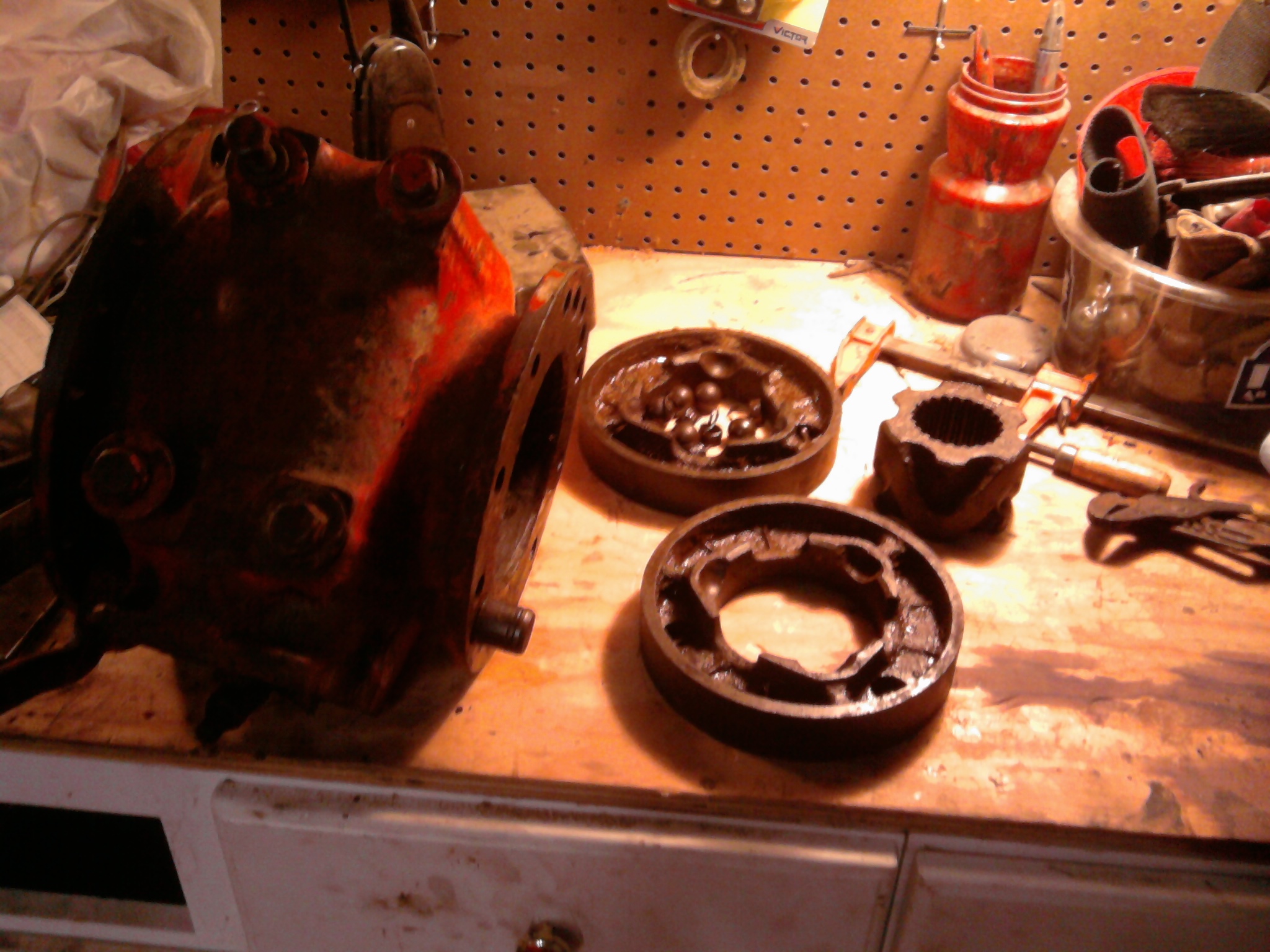

Well, I probably should've posted this up after I found the problem. After tearing down the trans I discovered that between the right side wheel and transmission there is what I would call a type of torque converter. Anyhow it is held together by three springs which had broke and caused the problem of it not moving when in gear because the side near the trans would spin and the side connected to the wheel would not. It's like two plates which had a screw like structure inside it with ball bearings between it and the outer sides... When too much torque is put on the drive shaft it twists the plates which turns the "screw" which, if pulled far apart enough will snap the springs. I hope this makes sense, it's kinda hard to explain... I might be able to post up a pic later.

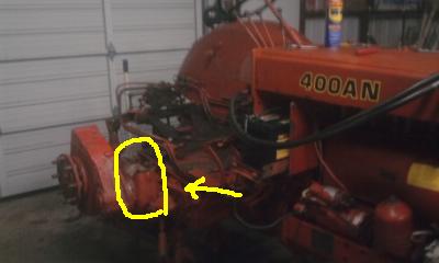

OK, I have never posted up pics yet so I hope this works.
This is a pic of the general area where the part is located...
and here is the part when I took it off the tractor and had it on the work bench.
You can see the two "plates" and the "screw" part... The ball bearings are set inside the further plate, and then of course the housing is on the left.
Hope this helps bud.:thumbsup:
