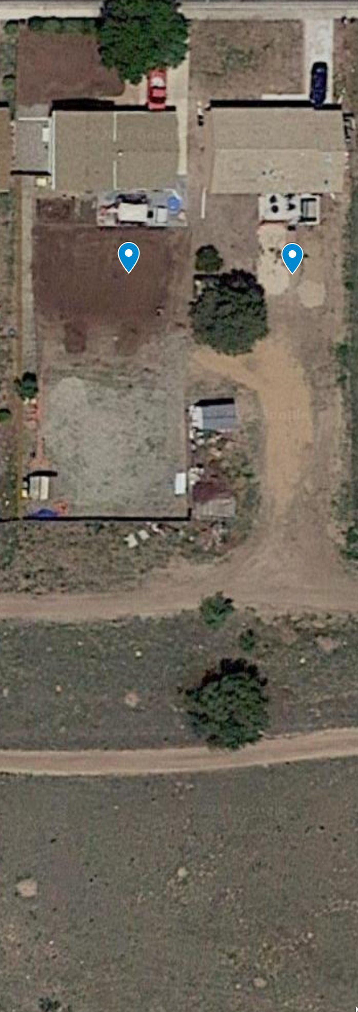

We have two rental properties side-by-side. Each lot is 180' deep, by 63 / 60 feet wide. 1/2 acre total.
I plan to cut both the back yards in half, creating a rectangle about 123' wide by 60' deep for my use.

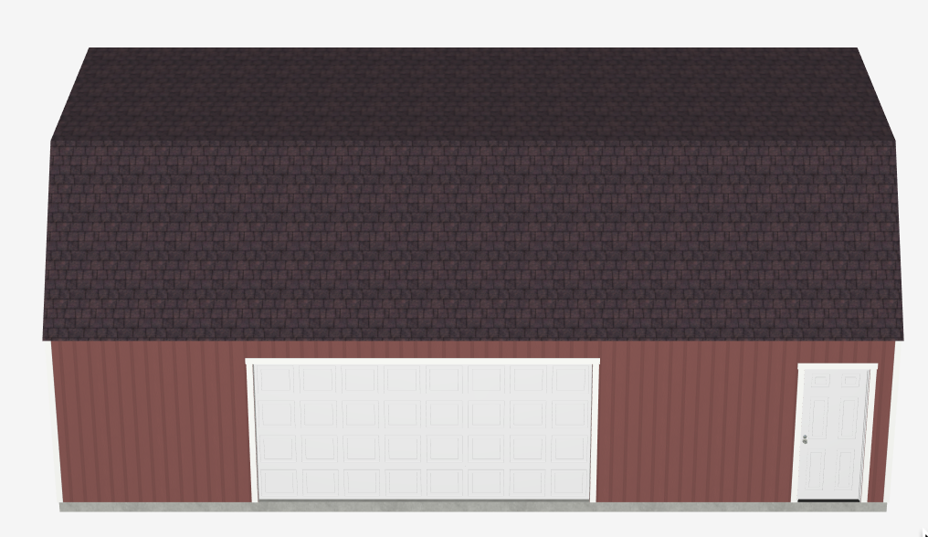

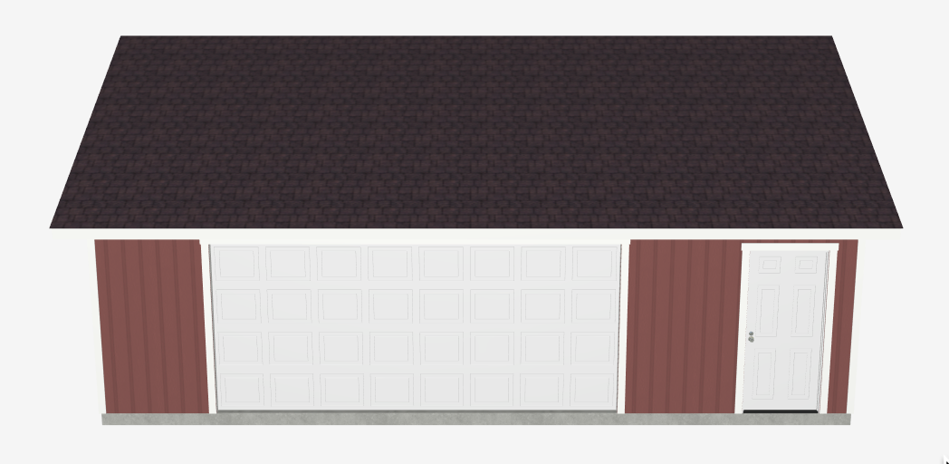

I was looking at something like a Tuff Shed 24'x30' Premier PRO Ranch Garage for $17K+concrete or a 24' x 40' Premier Barn Garage to the tune of $30K plus concrete.
Maybe even one of each. I assume a nice large detached garage would add to the property values, but we really have no intention of ever selling them.

My BX2370 & implements currently sit outside. Pickup truck, 5x10 dump trailer, and 2 cars too.
