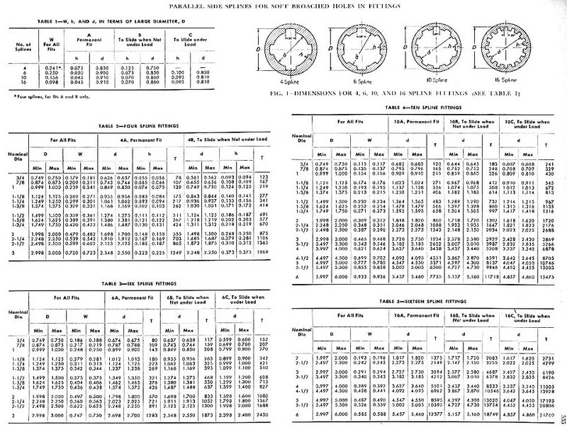

Sep 1, 2013 / shop drawings mfor pto spline #1 D davel745 Member Joined Jan 2, 2010 Messages 31 Location WV dose anyone have a set of drawings on the female spline used for the 540 rpm pto shaft. I also need the male counter part too. Thanks
Sep 1, 2013 / shop drawings mfor pto spline #2 Baby Grand Elite Member Joined Nov 12, 2007 Messages 4,649 Location Windsor, CT. Tractor Kubotas: L3240GST B2320HST B5100D & G5200H Can't help you with a drawing, but the spec you need to make a drawing is SAE J499. It's going to be a 1 3/8 6T spline with straight sides - pretty sure it's a 6B fit. If you'd like to avoid trying to make, there's always Surplus Center: https://www.surpluscenter.com/sort.asp?catname=powerTrans&keyword=PSSS Last edited: Sep 1, 2013
