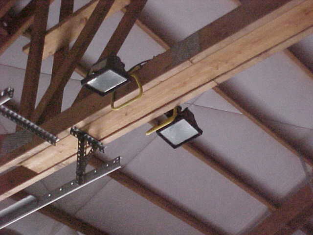

I use some cheap portable halogen shop lights. I run some recepticles along the ceiling and plugged them in. I have a switch for each bay that have 3 500watt lights. I driled the stands that the lights come with and screwed them to the ceiling joists. They give out a bright light and are adjustable on one axis.
