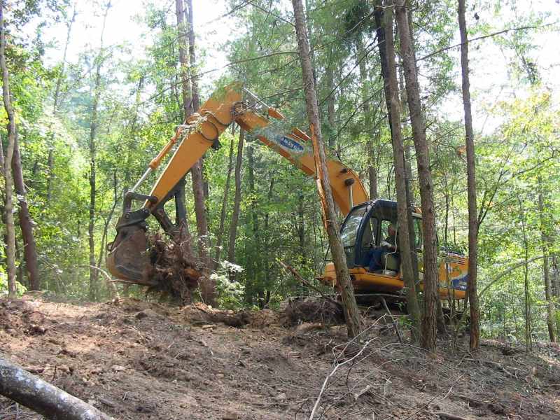

I've just cleared a house-site and driveway on a heavily-wooded almost 5-acre lot. Not sure exactly how well it compares to your situation, but you can see what I've done at the Major Lot Clearing link on this page.
Lot Clearing
I found that an excavator (or track-hoe) with a thumb on the bucket to be the most versatile all around machine. I've attached a pic. It will remove stumps much faster than grinding or with a dozer. We also used a dozer, and for just pushing dirt or brush around, it is the best, but the excavator is much more versatile...
Prices vary widely based on area of the country -- I paid $75 an hour -- with a fixed $200 charge to bring the equipment on site...
Also, I found that there was simply far too much slash to consider chipping it... I plan on burning it this winter when the woods around it are good and sopping wet. I'll chip the small stuff that comes from thinning the remaining forest...
