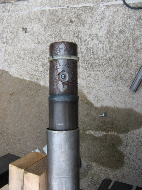

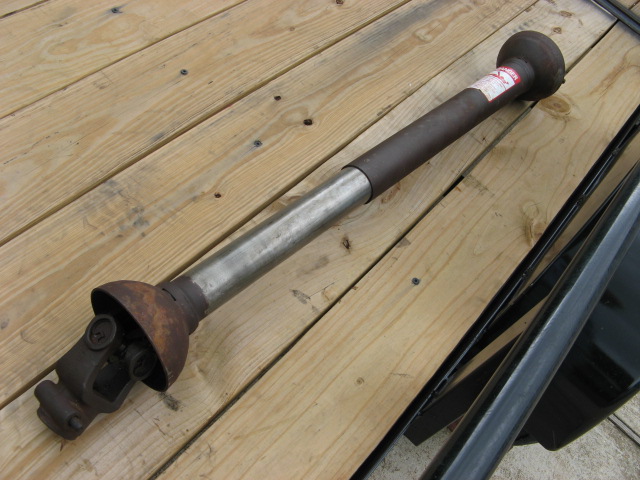

I need to shorten a PTO shaft 6 inches. No big deal, I thought.
I cut 6 inches off the one side, which was a solid square bar of steel.
I then went to shorten the other side 6 inches and found this:
The outer 6 inches is a welded-on sleeve with the inside shaped to engage the square steel bar; the rest of the shaft is just round tubing. If i cut 6 inches off this half of the shaft, the sleeve will be gone and there will be nothing to engage the square bar on the other half.
Do I have any options other than paying a driveshaft shop to cut and weld, or buying a whole new shaft?
How much can new shafts be shortened? This shaft apparently cannot be shortened at all, and looking at new shafts i think i would need to cut 20 inches or more out of the shortest of them.
Thanks.

Sounds like a trip to the driveshaft shop is in order. It will still be way cheaper than a new driveline.

you simply cut the tub off the yoke end.. trim there and reweld and keep it timed right.
no magic.. :)

I have this same type of shaft that came w/ my Farm King snowblower.
I was able to cut off the side w/ the square hole and re-weld it back on. I am not a pro-welder by any sort but it has held up for a couple years now.
However, I didn't realize it at the time and didn't keep the PTO in phase. So far it hasn't seemed to give me any problems.

Other thread about timing a PTO shaft. Its an easy weld, doesnt require a lot of strength for a tractor with 20 hp PTO. A muffler shop can do it.
Check post #10 of other thread for a note about timimg the U-joints when you reassemble.
http://www.tractorbynet.com/forums/welding/319105-can-i-shorten-solid-splined.html
I have a new shaft coming, a series #4, about $119.00 including slip clutch. Which means I have an extra slip clutch, which I will probably try to sell or maybe make a trade for a boom pole.
If I am measuring this thing correctly, the existing shaft is a "North American" series #35, good for 85 hp. The previous owner of the cutter had a 16 hp tractor. I can only assume that he lost the original shaft, went to the local farm store for a replacement, and this thing was the only shaft they had on the shelf that had splines on both ends.
