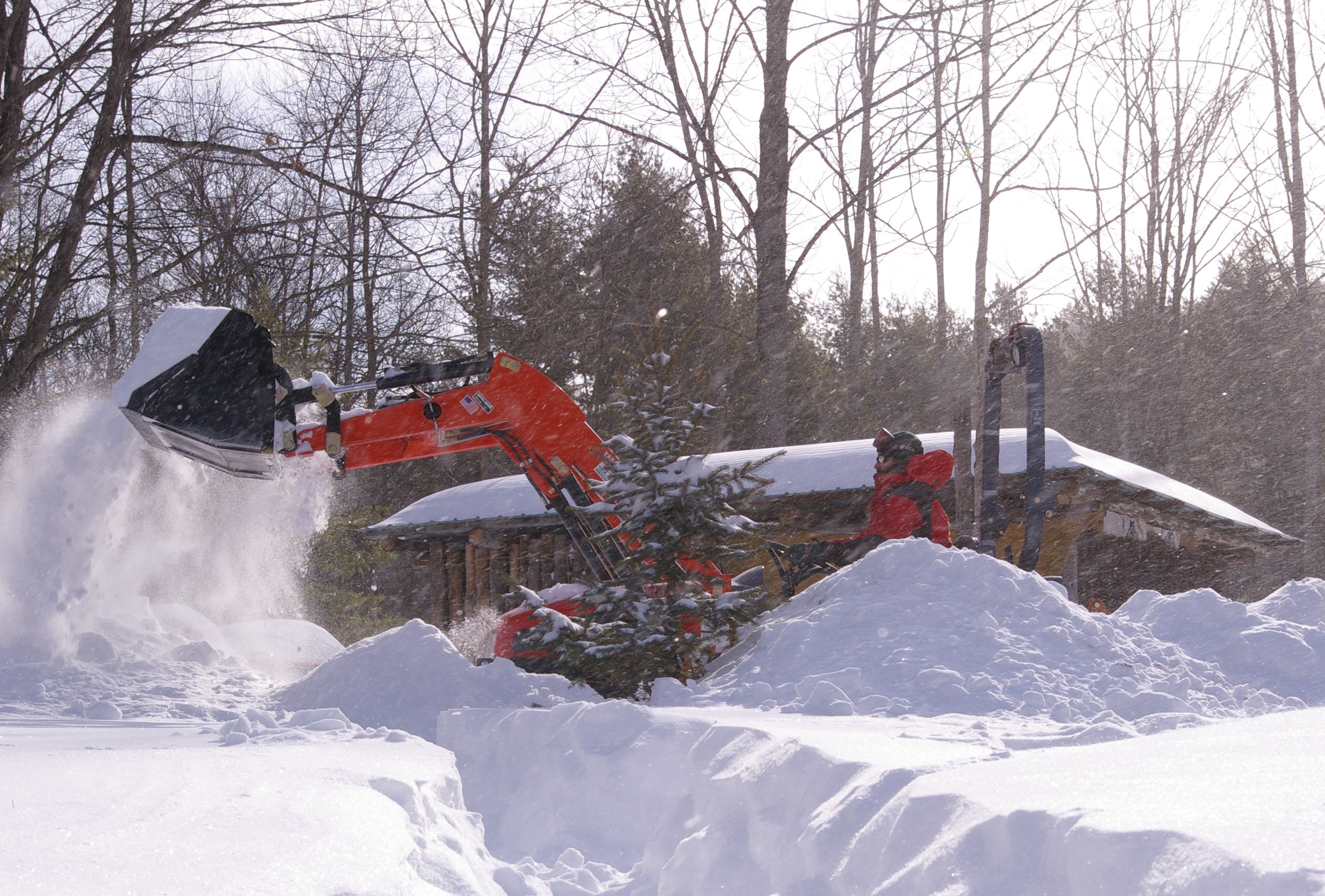

paulbr, winter time should be no problem. I used my ck30 w/R4s with fine results, even with a couple 30" dumps of the white stuff. Basically same tractor as yours with a couple more ponies. My tires are loaded and always had the RB on, thought about getting chains but haven't need 'em so far. There will be some more learning, like how to deal with slippery side slopes and such, but tractor learning is fun (as long as you take your time).;)
