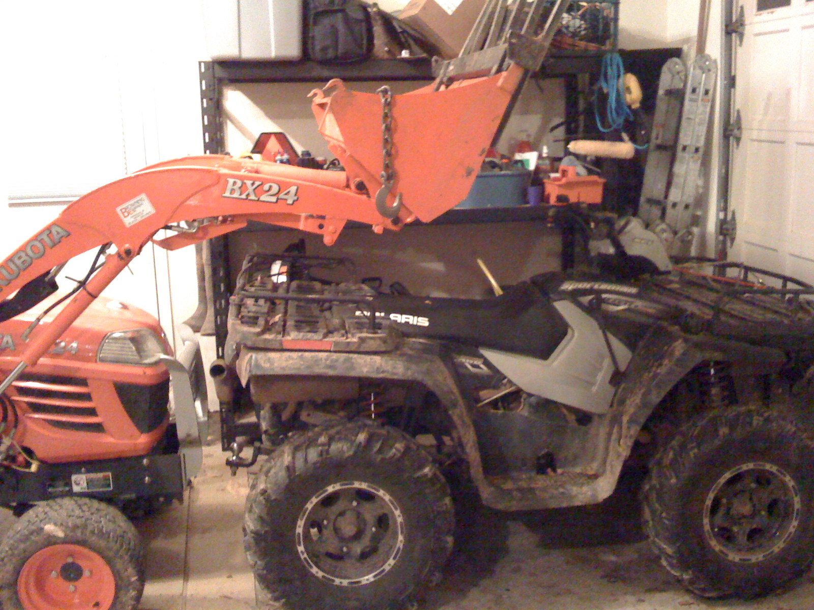

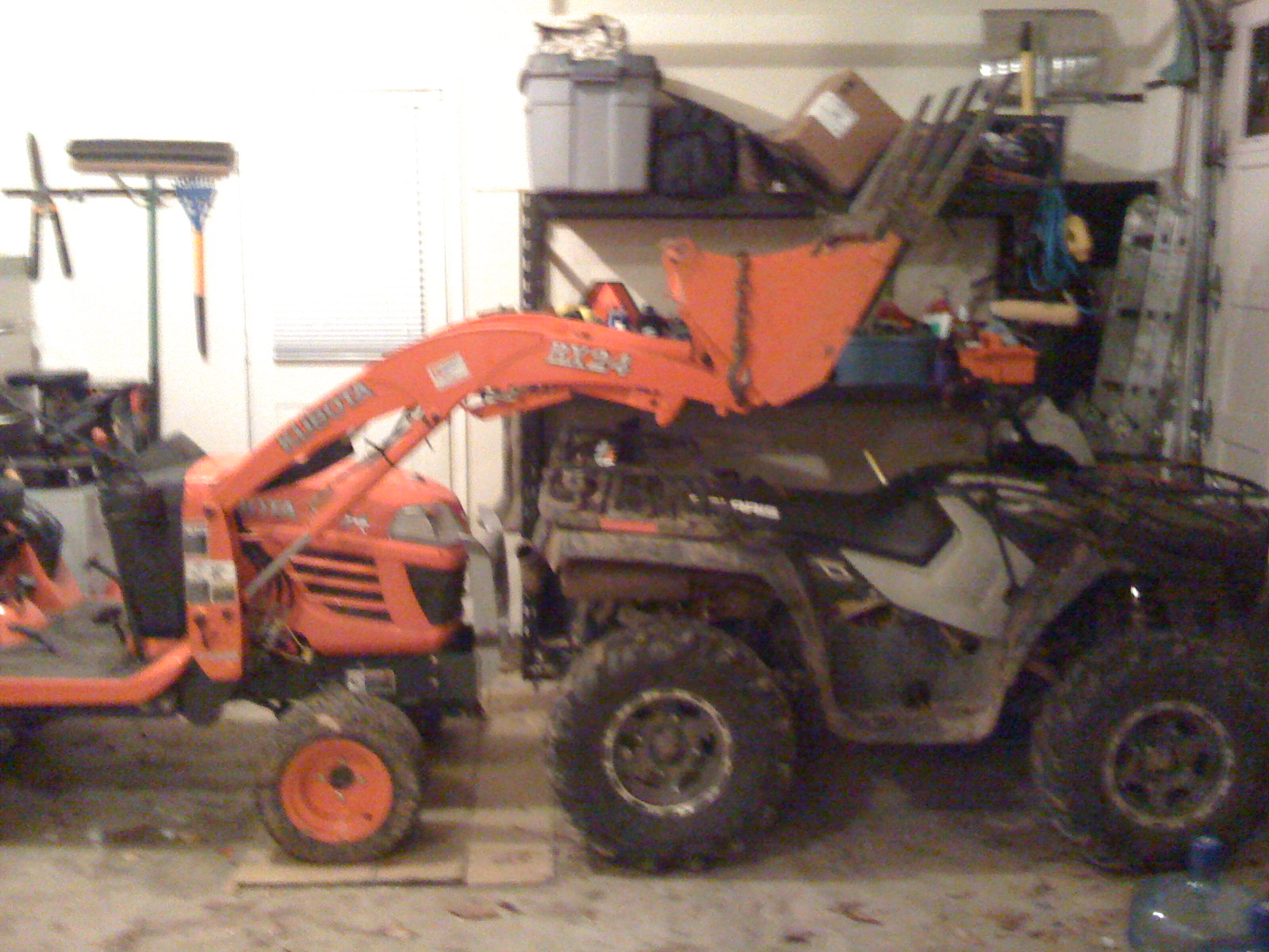

I park mine like this when it is really cold so I can get another car in. It does eventually go down but a lot slower without the brush fork on. Even with it on it took about 10 days. My kids loved watching it get closer and closer to the ATV.
