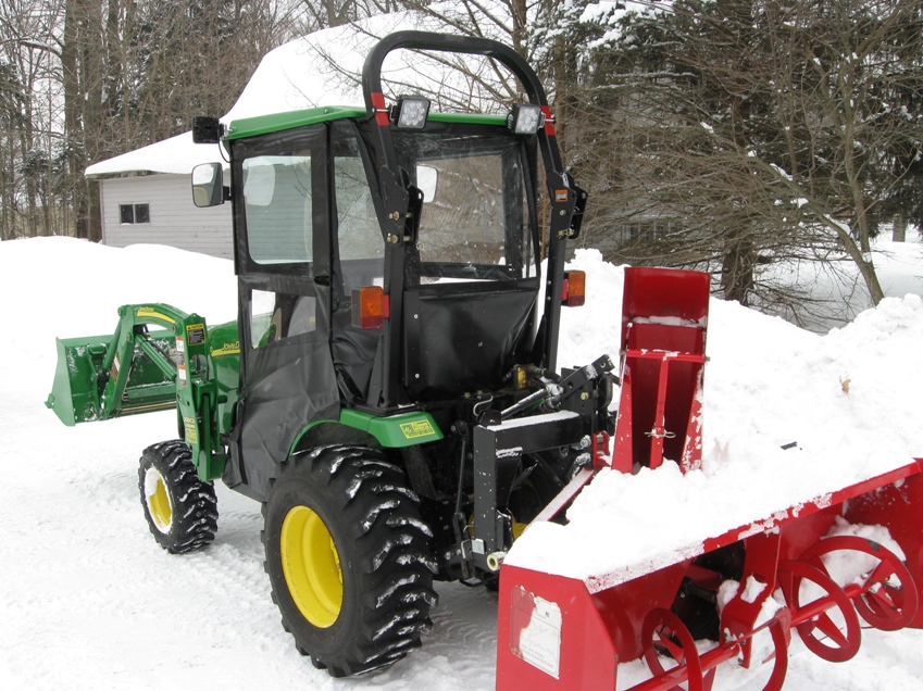

The OTC cab is a great option and will let you keep working indefinitely in most winter weather. I would recommend the optional safety glass windshield. I also added some Ebay LED lights to mine which works well. If you are doing short driveways (20 or 30 feet) your back blade and loader should be fine. Long driveways would have you looking at a blower or an angle blade.
   / Should I get a better snow setup?
All of the driveways in my neighborhood are long. Mine is probably the longest at 400ft probably. Most of the others are over 100ft. A lot of us, myself included, have chat driveways and using my bucket and blade always ends up pushing gravel in the yards. That's why I was considering a blower. It's no full shoveling and raking gravel out of yards and back into the driveway.
That cab looks great! What are your thoughts on quality? How hard was it to install?

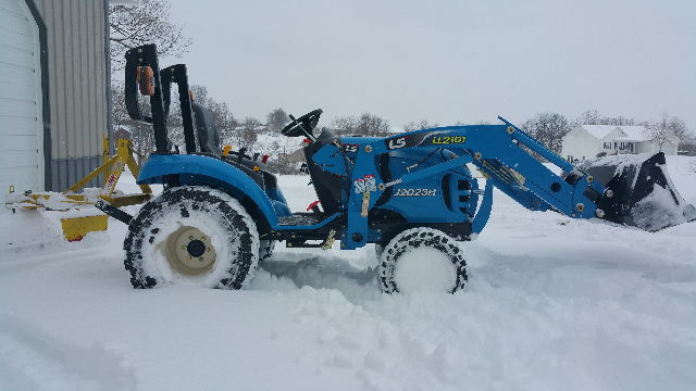

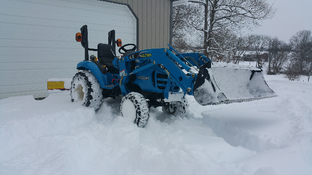

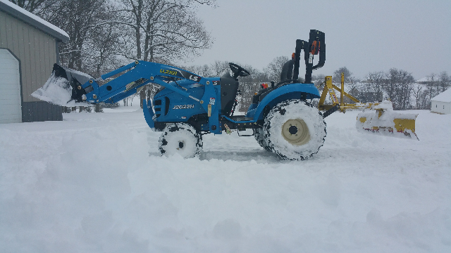

This is my machine this year. Had 12" all at once, then another 2 on top a few days later, then another 9" after all that had melted.
   / Should I get a better snow setup? #7
Olympus, did you have chains on your tractor? I doubt it, but I'm still asking. I know you had problems earlier in the year with your tires spinning on dirt until you had them loaded.
She looks great though!
