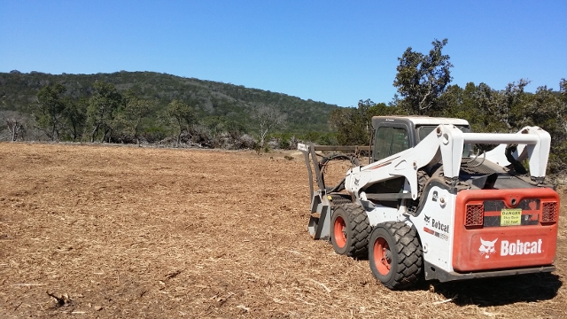

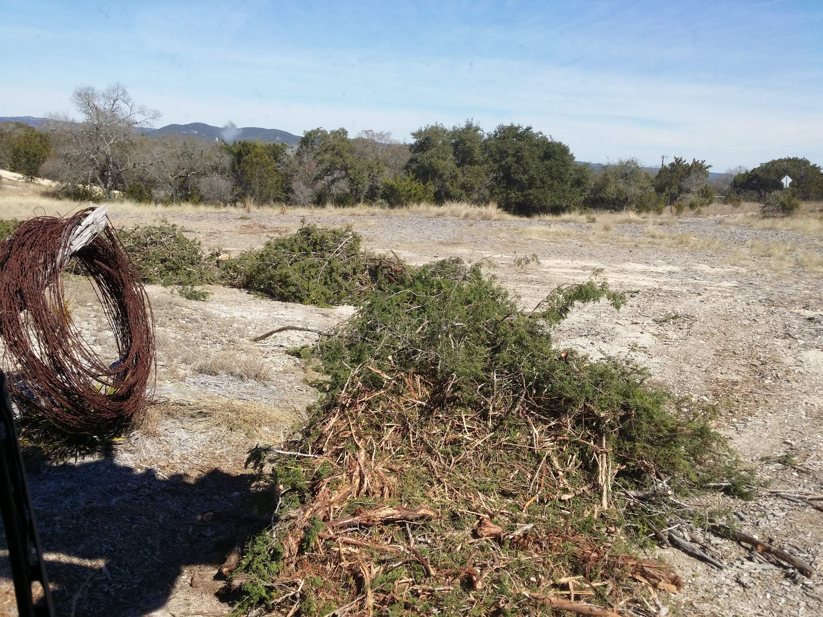

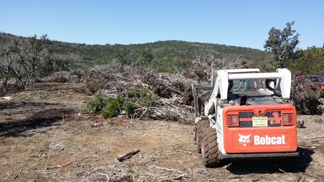

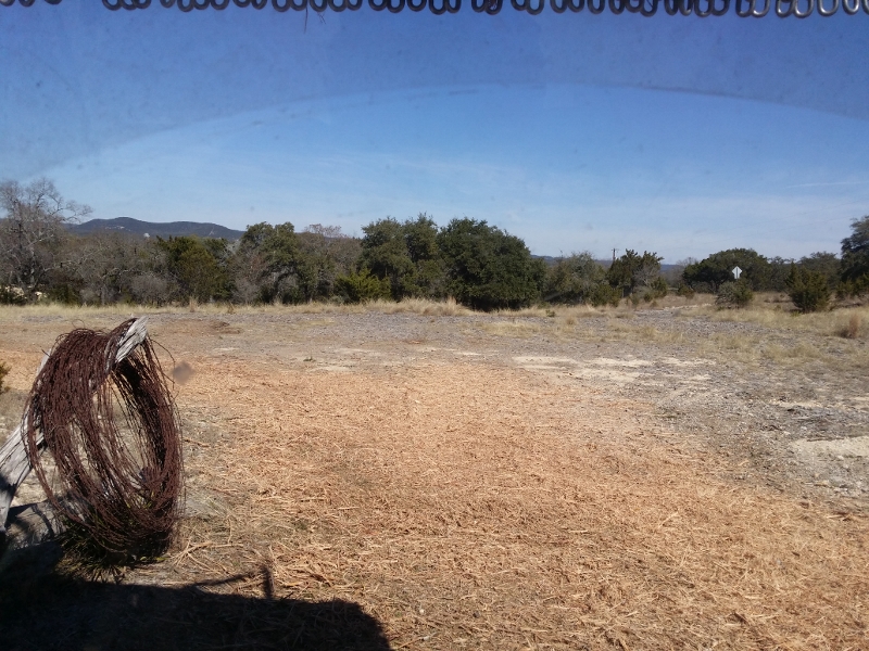

Some of the work with my Bobcat s750 and FAE VT head running carbides with a few cobra teeth.
I get a really good particle size but I've been wondering if it's too fine.. that is, does FAE do too good a job making the shreds smaller which, I would think, takes up more of my hp as the head encounters more resistance or fights through balls of shreds and brush.
