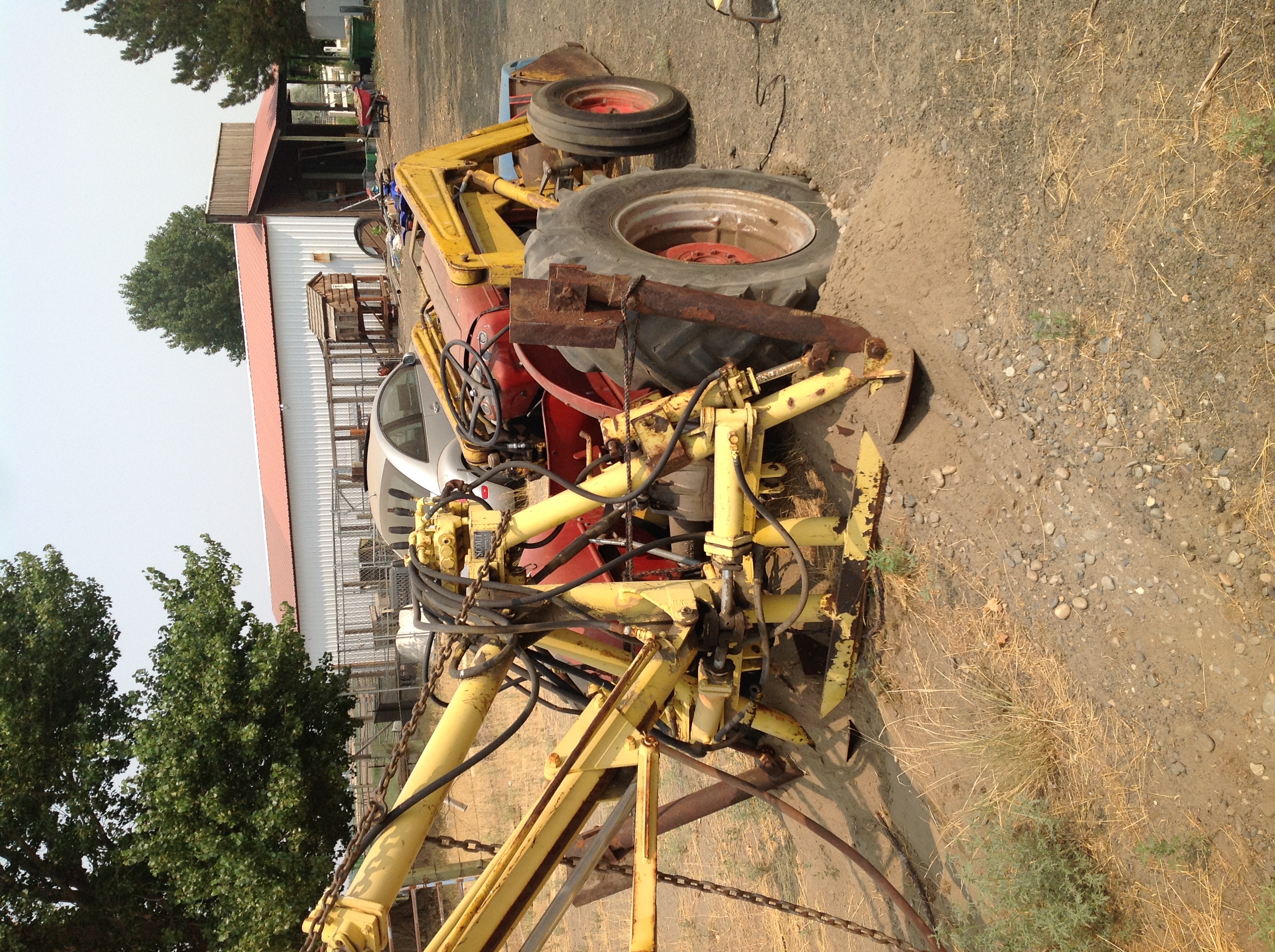

I got this backhoe attachment a month ago hooked it up to move it to the garage for repairs. At first it picked it up a couple of inches. I had a death in the family and had to , Put the project on hold . Now I'm back the tractor won't pick it up at all is it a bad pump or have I overloaded it ? 2nd Question can I put a bypass on the 3pnt pump that would run this backhoe?
Just need to know if I should sell it and get a smaller one or will my tractor handle it . image.jpegimage.jpegimage.jpeg

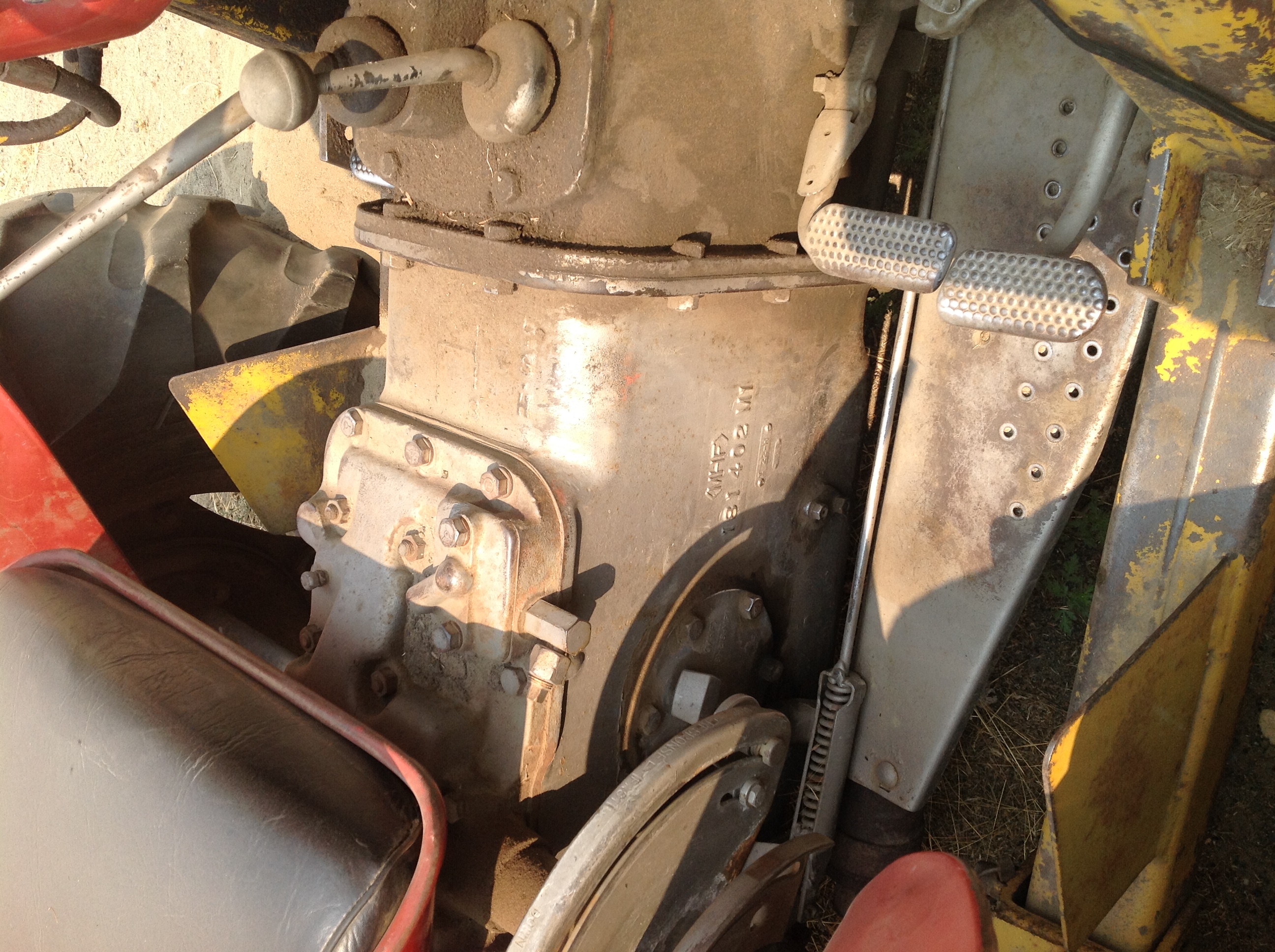

Firstly, is the oil level sufficient? Also, is the correct oil in the gearbox and is its condition satisfactory? Be aware the gearbox oil is used in the hydraulic system. Any reading on its dipstick should be sufficient for it to operate. The dipstick is on the RH side cover, under the control quadrant. Check the oil with the tractor on level ground, and the engine stopped. If the oil is whitish-creamy colour, this usually means water contamination. A lack of sealing at the boots on the gear levers are the most common points of water entry. If the oil requires changing, lower the 3PT and if possible drain while warm ie after working for a couple hours, drain at both plugs overnight. Refill with SAE90 or 80-90 gear oil, Universal Tractor Oil or similar is also suitable. :thumbsup:

The pressure relief valve normally doesn't make a squealing sound - more of a hiss or squelch is likely. It seems this valve is positioned below the oil level. California is correct - tap into the hydraulics at one of the Allen-hex headed plugs at the sides near the front of the top plate, load up the lift arms and read the pressure.

Impossible to answer if it's too much backhoe.
Don't know what the backhoe is, how much it weighs, how far you have that weight extended, what it's reach and dig depth are, etc.
Those old 50's and 60's tractors that looked like N series Ford's weren't known to have high lift capacities. As they didn't need it back then. And by today's standards, the 3ph components look wimpy compared to a modern tractor of similar weight and power.
Under normal circumstances yes the front of the tractor would lift first if you attached to something too heavy, but you have a loader on, so that changes that theory.
Do you have something else somewhat heavy to can test the hitch on? An old 6' bushhog? Or mounted disc? Or even a carry all platform you can load up with cement blocks to 1000# to give it a workout?

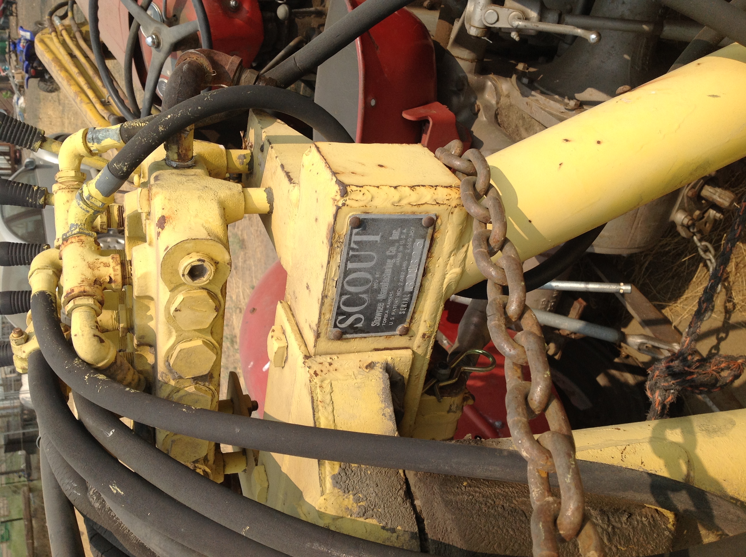

Not sure what you mean by "put a bypass on the 3ph to run it". You have a loader. How are those hydraulics ran? If the valve has power beyond, that would be a good source for power. As would a PTO pump with its own hydraulic tank.
In any case, the hydraulics need some serious work. I see more black iron fittings in that plumbing than I care to count.
Not sure when people started thinking it was okay to use a 150psi black iron fittings on a high pressure hydraulic system, but I almost wish hydraulics never adapted a NPT thread into their system. Leave it at JIC and ORB only, and that would make people use the correct fittings instead of whatever they can cobble together at the hardware store.

I have a similar machine - an MF40 Industrial - also with a loader, complete with the associated rather heavy frame for strengthening the machine. It has PTO and 3PT, which make the machine much more versatile. Interestingly, the loader is supplied by its own crankshaft-driven pump. The control valve block has a threaded outlet (currently plugged) which, judging by photographs of similar machines, I believe is to connect a supply hose for the machines also equipped with a backhoe. The pump is quite large and would have a much higher flow than the 3PT pump. runs the most logical idea would be to tap into the loader hydraulic supply for a much better-functioning backhoe.
